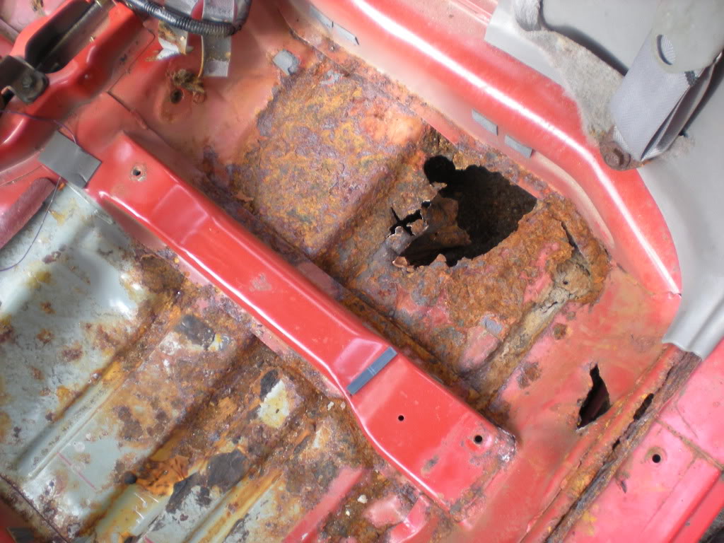

I've started tearing everything apart in my final searches for rust and to make room to repair known rust. got some pictures taken tonight for something to look at.
while I'm tearing the pedal area apart, anyone know how to make our pedal set up better for heel-toe shifting? usually the gas pedal needs raised to be level with the brake pedal and that definitely seems to be the case here.
any ideas how to do that?

One other coating system that you might want to consider is magnet paints: http://www.magnetpaints.com/. I just did the floor pans of my car with it. The thing I like is that it seems to be a lot more user friendly than por-15, and you can brush it on straight out of the can. I did end up with some minimal brush strokes, but I think it was the way I was applying it and the fact that it was 90 degrees out. I plan on using it on the underside of the car. I can tell you that it is very durable.

you think his car is bad!!!! I am working on my girls car as practice for my 87 hard top l98 camaro that needs some rust work. hear are a few pics of her metro vert to give you a idea of what is possible with enough time and willing to do the work.
pan from donor car
so If I can fix this junk box it is worth it for a third gen as long as its still strait.
