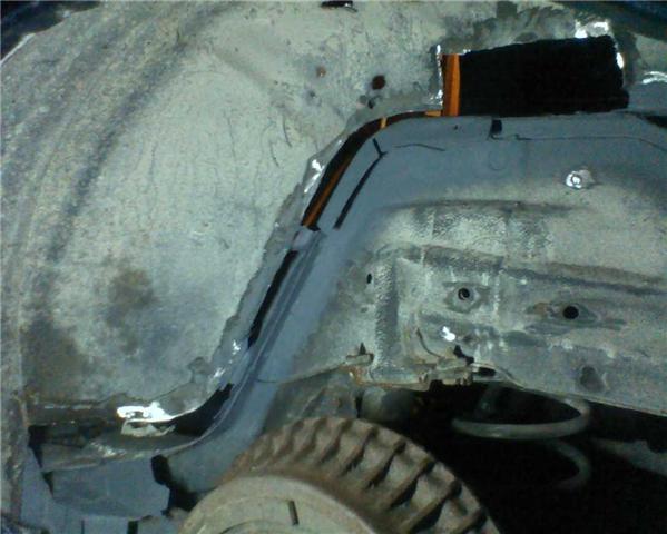

Fixing Rust (suggestions/input welcome)-rust2.jpg

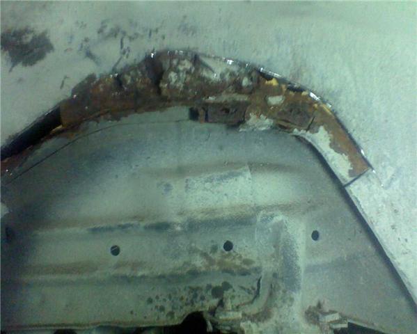

Fixing Rust (suggestions/input welcome)-l_a5fcd29700484e36be8e9e71637fb159.jpg
here is some rust damage on my car

this is just after poking it with a screw driver on the passenger side

on the drivers wheel well
Attachment 178332

befor and after pictures

thanks for posting pics chevyrs-305. I've got the area sanded and primed to give everyone an idea of what I'm expecting to cut out and replace. I'll post that later. currently saving up for some sheetmetal.
