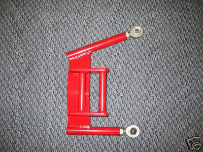

Hey people! been awhile since i have been on. Starting to work on the 82' again and i wanna do a 9" swap. I have an axle already and all the brackets to weld on. I just need the mount for the torque arm mount. Does anyone know where i can pick up a mount kit or do i have to buy a third member? Any help is greatly apprecitated. Thanks

You could fab one up or I think strange engineering sells them.

i priced one about 8 yrs ago from currie $150. i just used ladder bars instead.

Currie still sells the mount bracket. All the other brackets for the springs, shocks, panhard etc are removed from a third gen 9 or 10 bolt and welded onto the 9". Measure 3-4 times before welding.
