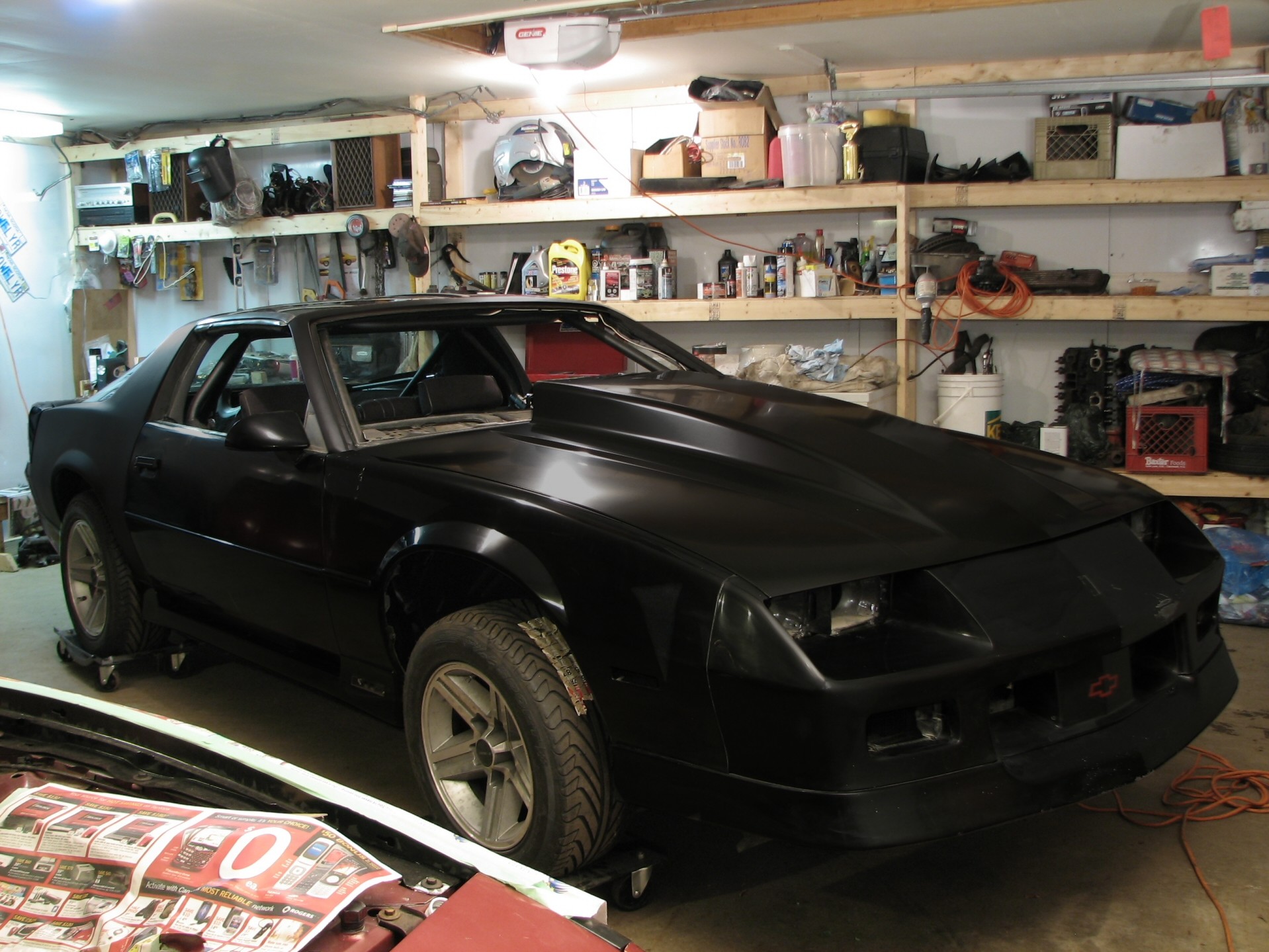

My car is partially reassembled, with interior, suspension blah blah back on it. There isn't any way to get decent pictures right at the moment. I only have what I had taken before. Once I have the remaining parts to put the driveline in place I'll finish the mock up and then be tearing the car back down to the unibody to go back on the rotisserie for final paint. I can send you some better interior pictures then.
For the rear area over the spring perches, there was a hole cut in the floor, a small 1/8" thick plate inserted on top of the spring perch and welded, then a piece of rectanguler 3/16" thick (can't remember the dimension, thinking 1.5" square or something) square tubing welded on top of that extended flush up to the floor. The piece was then welded back into the floor flush, but with holes drilled about 1/2" apart around the perimeter of the square tubing. This gives direct weld points from above to the support. Once the 6x6 was laid on top there were corresponding holes drilled to give access to plug weld the plate to the support, ans then the plate was welded around the perimeter as per usual. The plug welds were ground smooth, then the roll cage welded onto the plate. None of this is visible now of course.
For the main hoop mounts, a similar approach was taken, with holes cut, bracing inserted, welded and brought up to be accessed by the floor plate and the cage welded on. To make this look clean inside, the floor plates were first tacked into place, then I used acetylene to heat and form it to the floor's original lines. The plate was removed for the hole to be cut and the same approach taken as on the rear mounts. Perhaps the view from below looking into the LCA mount would show the plate in there. I'll have to see when the car is disassembled again. I did not thnk when I was doing this that I should take pictures, there isn't alot of pictures for any of the cage install.
As mentioned, the car is only in a mock fit but I'll attach a picture for you to see the current state.
-Brad.
