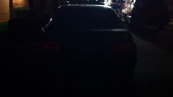

Here's mine with 3 bulbs...
http://www.youtube.com/watch?v=8lW-4vIS7XA
http://www.youtube.com/watch?v=Ss6LN...eature=related
Here's mine with 2 bulbs...
http://www.youtube.com/watch?v=kUGWT9uFlxU&NR=1
had issues at first but none after I figured out how to keep water out of the unit...All my bulbs are led...not autozone crap either. 3rd brake lights bulbs in the 2nd vid were just some ones i tried out, didn't work well in the day, got better ones.
Adjustable no load flasher was necessary for me, so there was enough time for bulbs to complete a cycle.
Painting the lenses didn't last long for me, maybe I did it wrong, don't care. Had them wrapped in vinyl. Reverse lights are 2 led strips on the bottom of the plate.

Got mine in. I cut the housings and added a 194 bulb/socket to the brake and turn section to light separately from the stock bulbs, and the corner 194. It's too dim and the parking light and brake overpower my little 194s in the middle section. I actually wired the 1156 turn bulb to come on with the brake to light those 2 sections upon braking. I have redded out the amber turn section and blacked out the entire tail. So when braking all I can see is the corner bulb blinking. I read on my ranger forum of guys putting h1 bulbs in their reverse section, wondering if I can swap h1s into the 194 sockets to brighten the output.
They also turn on and off so fast that the sequence is almost too fast to notice, especially on the right side. I'm going to experiment with resistors "led style load levelers" to slow down the flash rate.
Video
de68e060.mp4

Re: Sequential taillights
Video
Wow. Those are blinking pretty fast. I hope that isn't normal & I know the videos that BigBadLou had posted don't show them blinking that fast.
My understanding of it though, is that the blinking speed is controlled by the flasher on your car, not the STS unit. If that is right, it looks like yours are blinking double-fast, like when a bulb is out & the flasher flashes real fast to indicate that a bulb is out somewhere.
change you flasher to a 552 flasher and it will slow it down. but even with the 552 flasher the outer bulb will light up but it dosen't have enough time to burn bright. with the taillights off it looks great but with them on the other filiment out shines the turn signal filiment. i ordered an adjustable two prong flasher but before i recieved through the mail i tried using LED bulbs and this fixed some issues i was haveing. so i have an adjustable flasher that i dont need so if anyone needs one i have one for sale. check out this link there may be some helpful info.
https://www.thirdgen.org/forums/elec...formula-2.html
