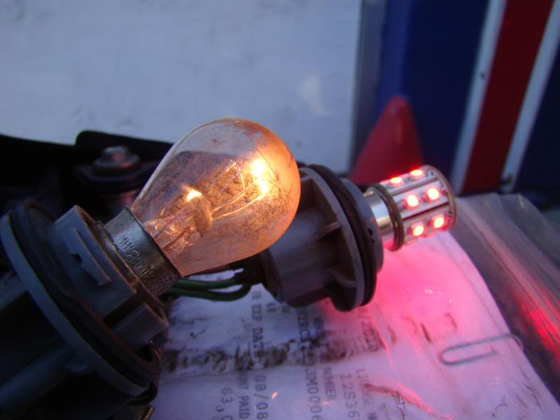

Originally Posted by 91banditt2
this video is with the stock 1157 bulbs with the 552 flasher
http://www.youtube.com/watch?v=y1KJUkOtcmc
this video is with 1157 LED bulbs and the 552 flasher
http://www.youtube.com/watch?v=DOZbOkXkOsA
i got the same flasher but mine still flash fast and it is turned down as slow as it will go, how did you get yours to flash slower
http://www.youtube.com/watch?v=kKXJSbYKgkg
Are you using LEDs?
I'm using the stock 552 hazard flasher for the turn signals.
Are you using LEDs?
yes i'm using led bulbs i got the 552 nl adjustable flasher for the turn signal. i did notice that the hazzrds flash slower

Originally Posted by BlackenedBird
I put mine in (got it through Amazon).
I installed it. Turned on the flasher. Walked to the back to look. Too fast to me, so I got back inside. Shut it off. Adjusted the screw all the way down. Turned it back on. Got out to look at the speed...Nothing. Wouldn't fire up again no matter what I tried. Needless to say, I sent it back. Amazon got it yesterday & I'm waiting for the refund to be applied to my account now.
Still looking for another one, because I've never seen an LED bulb that could light up the complete lens good without looking like a small circular light behind the big red lens. That & I'd need 8 bulbs for my car. At (give or take) $10 each? I'm not gonna spend $80 on bulbs!
I believe I posted the link to the adjustable flasher that I got and is working perfectly...also get used to prices for bulbs. you need a bulb like this
that burns red, burning white will make your taillights pink.
You need light to shine around the whole inside of the housing. Mine have over 30 leds on each bulb. I spent $30 per pair...x 3 pairs...just for tails/turn signals. everything else in the car is led too.
