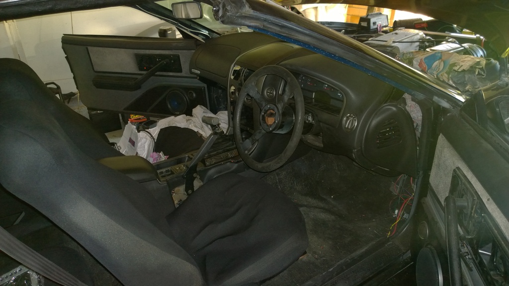

Hey LX_SS,
I've put my custom dash on hold till I get more time, and went back to a VY dash like yours. Because i kept the trans hump and firewall stock, it's nowhere near as nice or professional as yours, but I've hit a wall with the gauges.
I bypassed the BCM stuff following the x24 SBC conversion here on thirdgen, most of the gauges I should be able to get working, but the fuel gauge is for the commoore senders, 40-250ohm or something where as my 85 transAM is 0-90. How did you get around this?

Hey mate, Any updates?
Thanks so much for your help with mine, the dash is all in and operating now, only 2 errors, low coolant (which i just need to earth the wire) and fuel gauge calibration error (just need to use the software to recalibrate)
BCM detects, PIM works without linking, all gauges work, indicators, headlights the lot
I went with your suggestion too and got the calais L3 cluster

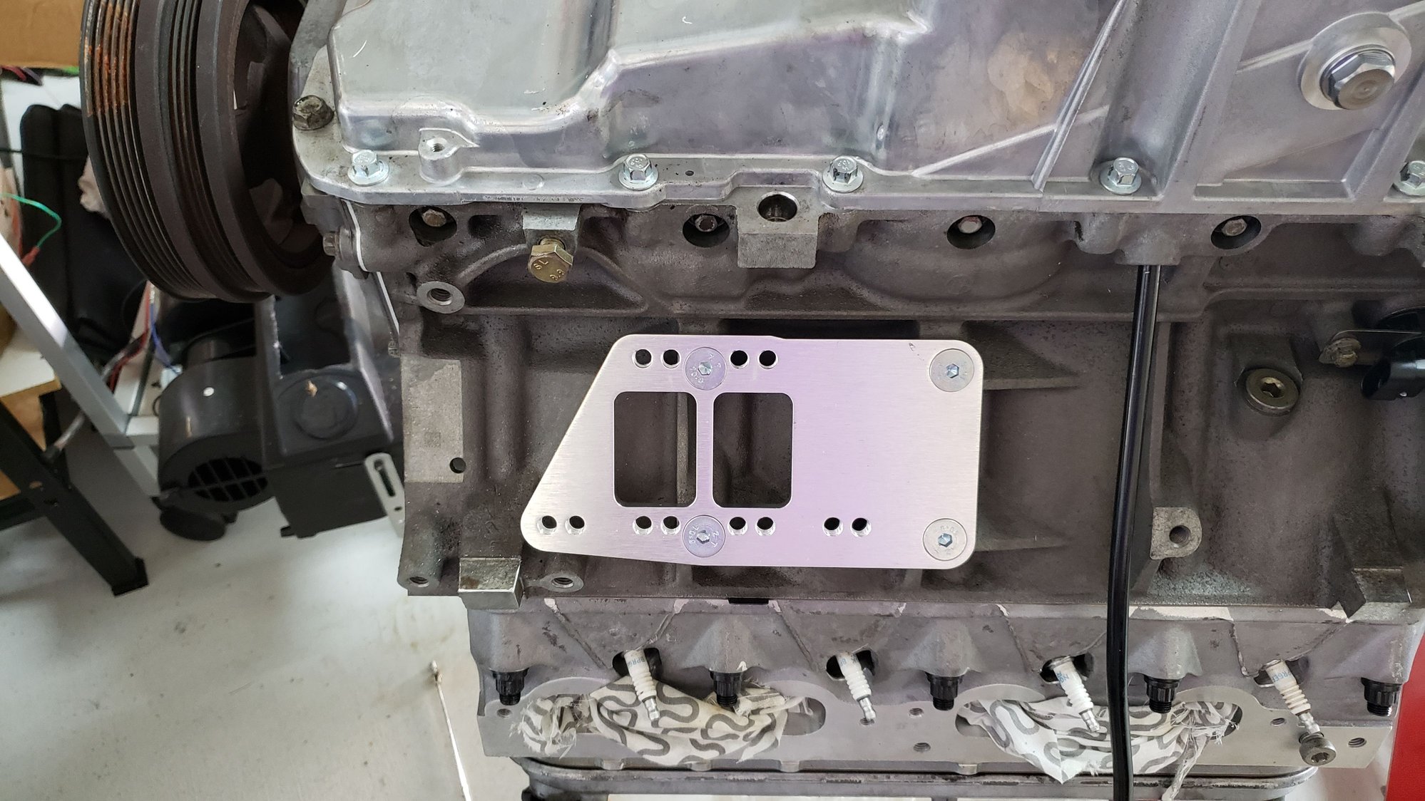

Yeah it's been a while. I finally got a decent shed to work on the car so I've been busy getting the Ls1 swap done.
Surprisingly the "clipster" style ls1 headers fit perfectly for the drivers side, irgonically though, the passenger side hits on the bit extruding from the firewall, which I was going to ask you about whether its able to be notched or if it's a structural part of the frame/chassis?
Here's a few pics of where I'm up to.
I'll take a picture of the alternator to show where it's hitting as well as how far forward the engine sits

very lucky score on those headers.
these are the bolt locations on your mounts that i used.

also i think your plates are wrong way around, left vs right
haha, yeah sorry, these were the old pics when I was first putting them on and then realised.
Yeah the headers were fine for steering side, but passenger side will still need to be modded somehow.

In the meantime though I've pulled the master cylinder and booster from the donor VY still sitting on the front lawn and I'm going to see what's needed to mod to put that in, as it gives me a couple of inches extra clearance and should hopefully work a bit better than the 37 year old brake technology of the TransAM.
I've got 97 LT1 Camaro single piston brakes on the rear and stock 85 TransAM single piston brakes on the front, but all new lines, new hoses, and it was a new master cylinder and booster, but the brakes felt crappy and cam wasn't building enough vacuum so I wired in a VE auxillary vacuum pump to kick in and out when needed.
Hopefully the VY BB and MC will help it out a bit more.
I'd like to use the calipers from the VY as well, but I don't think I'd be able to find any adapter brackets for that.

I bought a 3d printer to get started on the custom style dash, trying for a Tesla style with a 24" touch screen in the center and do away with the commodore dash but this time I'm going to build it all outside the car separately and just transplant it in when it's done.
Also bought a 6L LQ4 short motor so going to have a go at a twin turbo setup, but it's going to involve moving all the accessories back to stock positions to get space to put it all in.

With the dash idea, Can i suggest, one of two things, first and foremost, build the frame out of small diameter steel tubing or rod. Then least that will give you structure and points to mount sections off.
If you dont want to do that idea, then make a buck of the mount points from the car, then use that to make a frame mimicking the car's mount points. That way you can build it entirely out of the car

So the dash is done

Bloody hell stu, where is the flux capacitor? Lol
