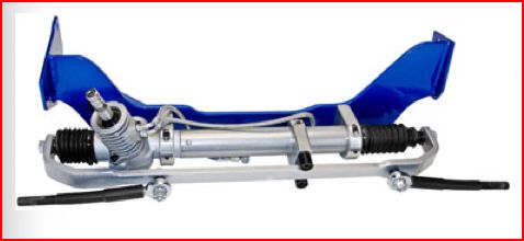

http://www.unisteer.com/bolt-in-rack...k-pinions.html
I'm pretty sure that at least the Torino and Maverick are front steer. Probably some others as well.

I called Flaming River and Unisteer. The most travel you can get out of their racks is 6 inches. This has me pretty close to giving up because I'm not real excited about modifying my spindles and I'm not comfortable with the available aftermarket spindles in a street application. I may be rebuilding my stock box.
