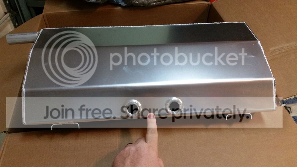

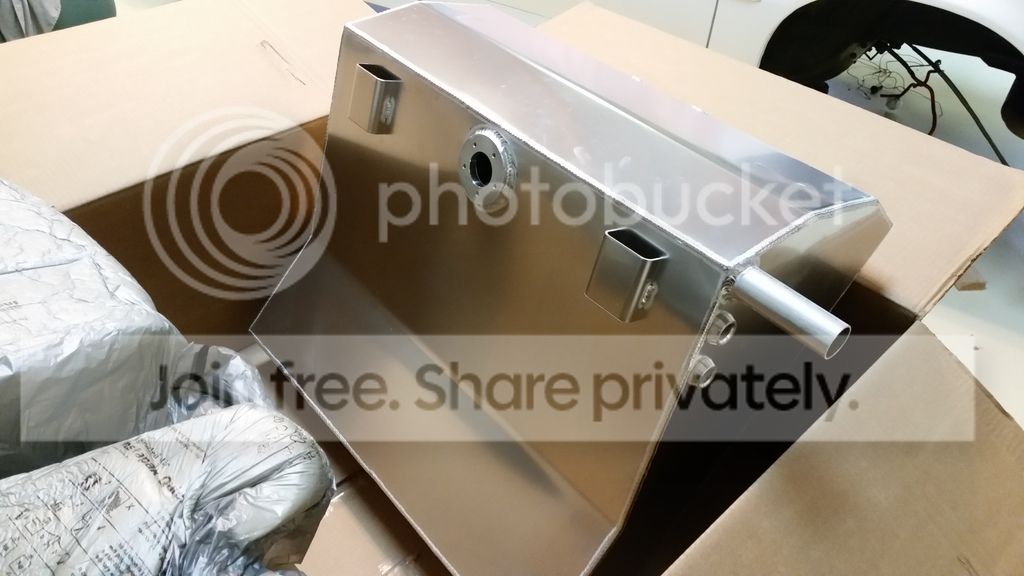

or ya could add one that fits with the stock mounts/straps...(lower back of aluminum tank 12an fittings)
top of tank..showing 2 10an return/vent..and sending unit location..
filler neck using the cap and top of neck off of later Camaros..it also drops 15+lbs off the car..
