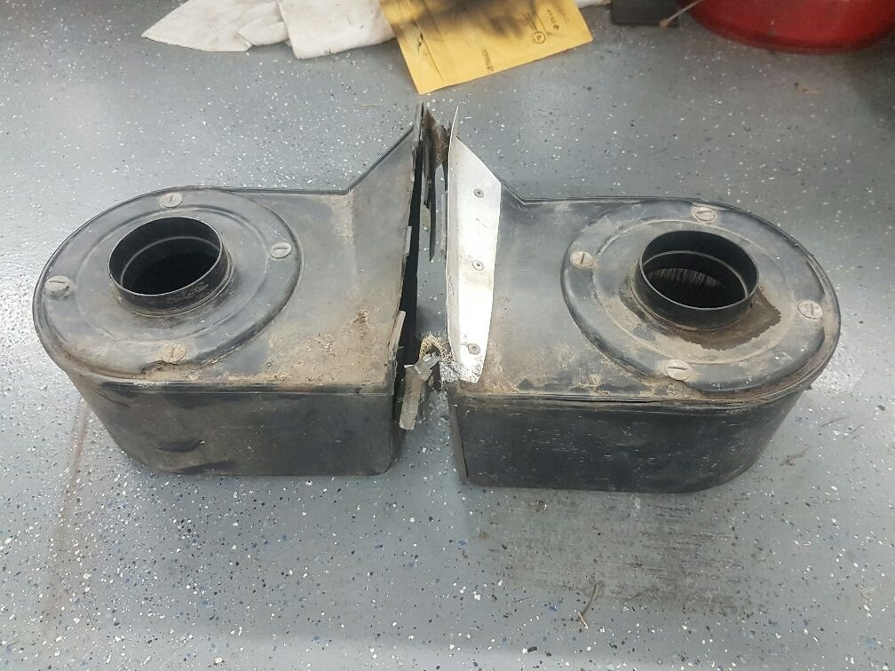

Few months ago I bought a car for the air cleaner assy and its in rough shape but it is what it is looking for info on repairing these things.
plastic welding new plastic to existing? possibly making bigger and better aluminum to better repair like PO did although the pop rivets have the plastic cracking near the rivets, Please, your thoughts or if you have any experience with plastics I'm guessing these were made out of PVC plastic? the rest of the housings appear to be OK IMO

That repair with the aluminum sheet doesn't look too bad. I've seen much worse fixes. Go to YouTube for videos on plastic welding; helped me immensely. I have a '97 K2500 EC with a 7.4L that I'm still working on. The parts like the radiator shroud are N/A so I had to fix it and plastic welding was the answer. The main thing is that the plastic that you use for repairs has to be the same exact type of plastic since you're essentially melting the two pieces together in a controlled fashion. I had a spare SBC shroud that I could sacrifice for welding material for the shroud that I wanted to repair. The plastic has to be cleaned as well; just like welding metal. Brake cleaner works pretty well after a good scrubbing with a Simple Green or Purple Power cleaner.

It could be #5 or PP plastic, and not PVC. That PVC wouldn't work as fill material.

Get a smooth backing material with some rigidity, clamp it over the flat area as a backer. Wax your backer with a release agent, and lay up fiberglass cloth and resin to replace the missing material. When you've got it relatively solid, go in with a strong slow curing epoxy filler, and blend it all in. Sand excessively until it's smooth, clean well and spray with semi-gloss black Krylon Fusion.
It wouldn't be quick or easy, but with a little care it'd look the part, and you'd have a more structurally sound part. The center duct seems to be a heavier composite, it's just unfortunate SLP didn't bother to use a glass fiber reinforced plastic.
Alternatively, use the original parts to fab plugs. Use the plugs to create molds. Use the molds to lay up composite copies. ???. Profit.
