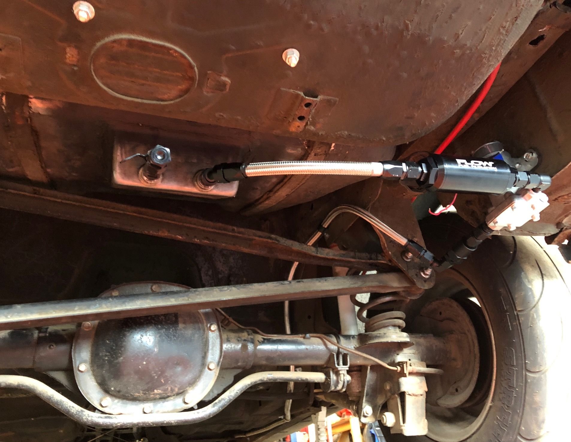

I also have a sumped tank, I didn't make it, i bought a roller 86 T/A for the 9" and it just hapened to have a sumped tank, so I snatched it to. I am using a holly blue pump and a jegster filter....i still have to wire it up to the factory harness......here are some pics....
Attached Thumbnails Sumping stock tank?-dsc00897-1024x768-.jpg   Sumping stock tank?-dsc00898-1024x768-.jpg   Sumping stock tank?-dsc00899-1024x768-.jpg
