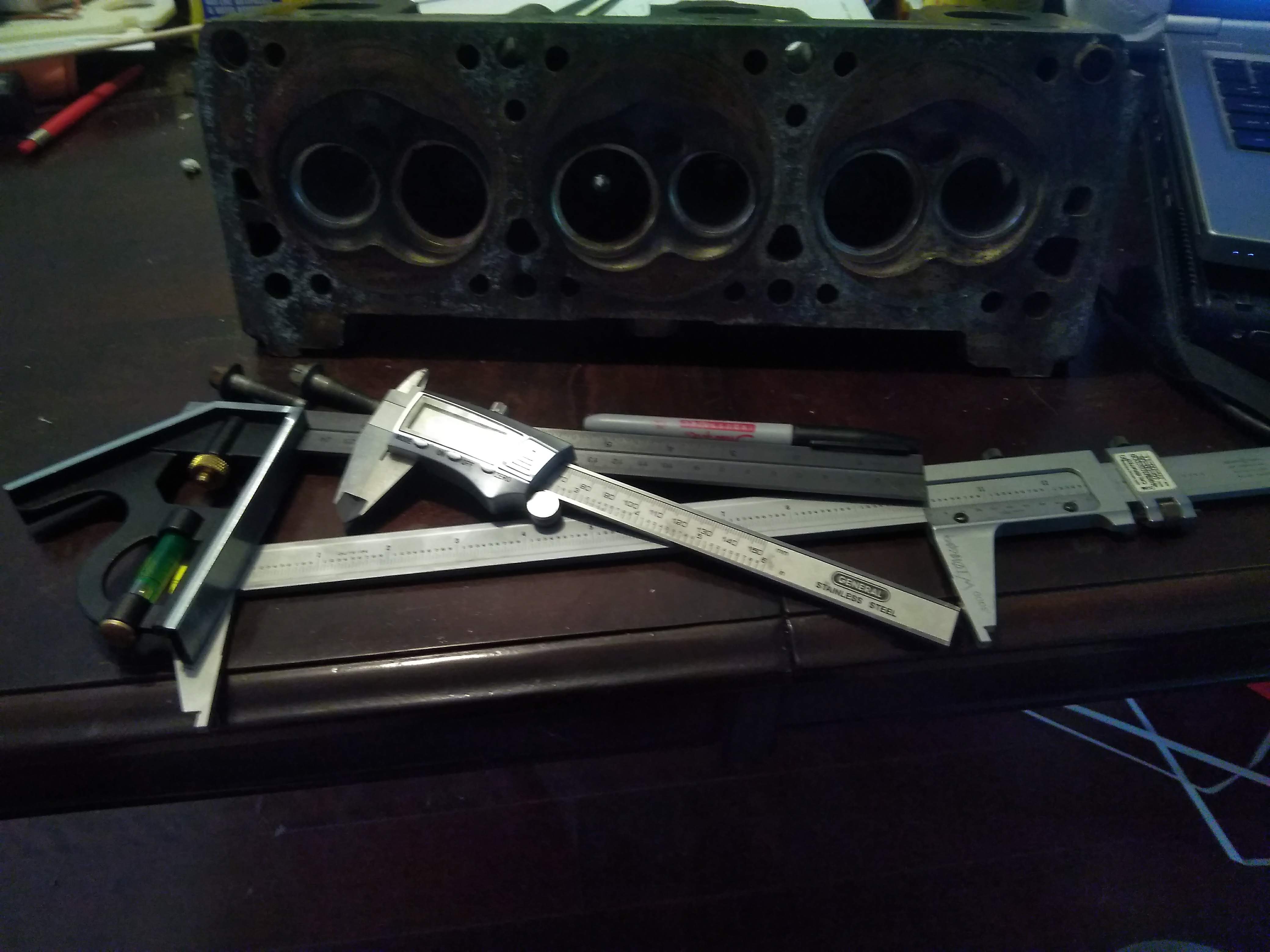

so, everything is garbage, what do we do? we make our own! how? some simple measuring tools, some time, a spare head, and a cad program.

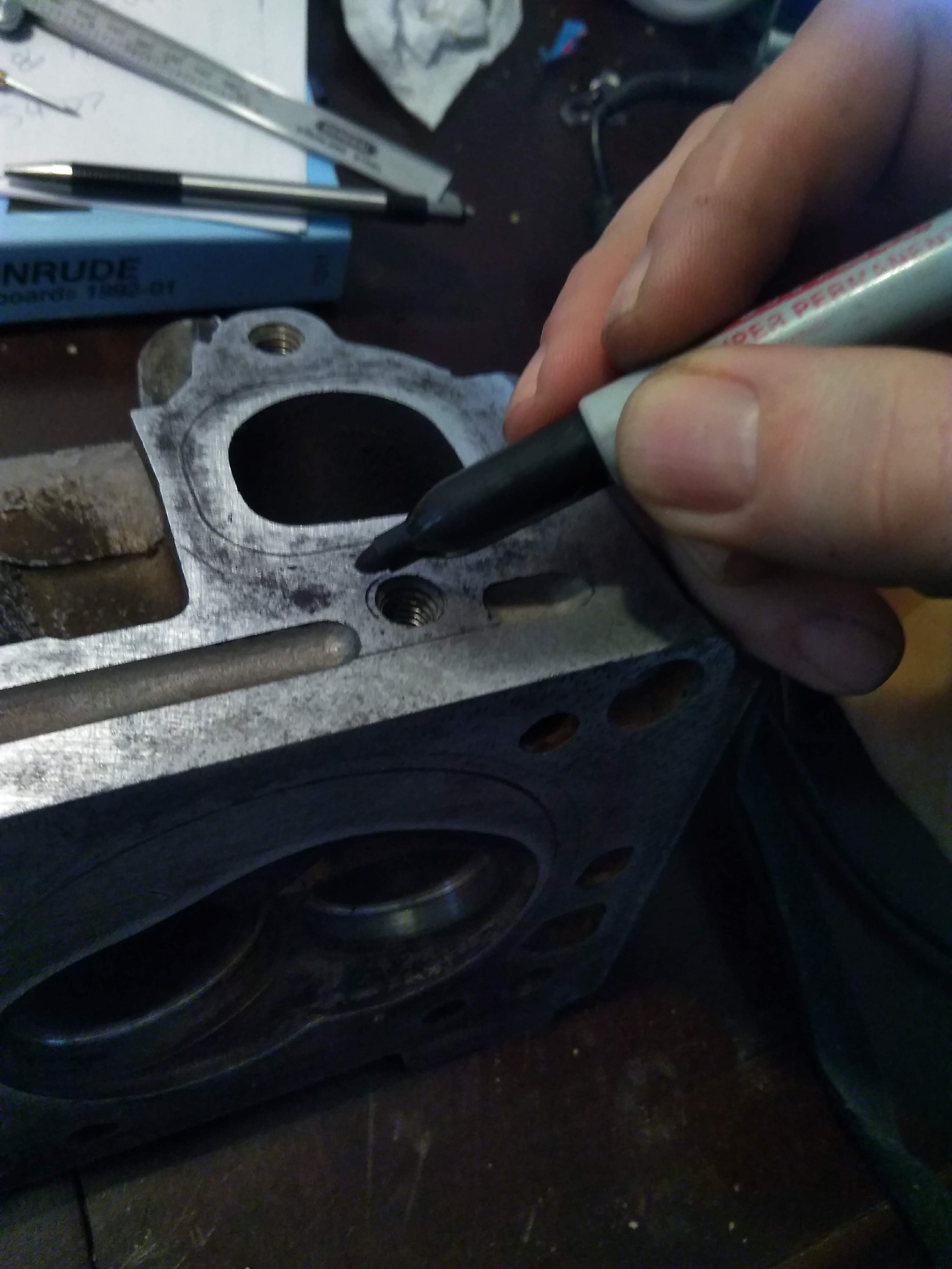

to start things off, I cleaned the machined surfaces of the head, they need to be free of dirt and surface irregularities that could cause any measurements taken to be off.
next, on the machined surface the flange will mate too, color in the whole thing with a sharpie, or machinist's blue if you feel like making a huge mess...

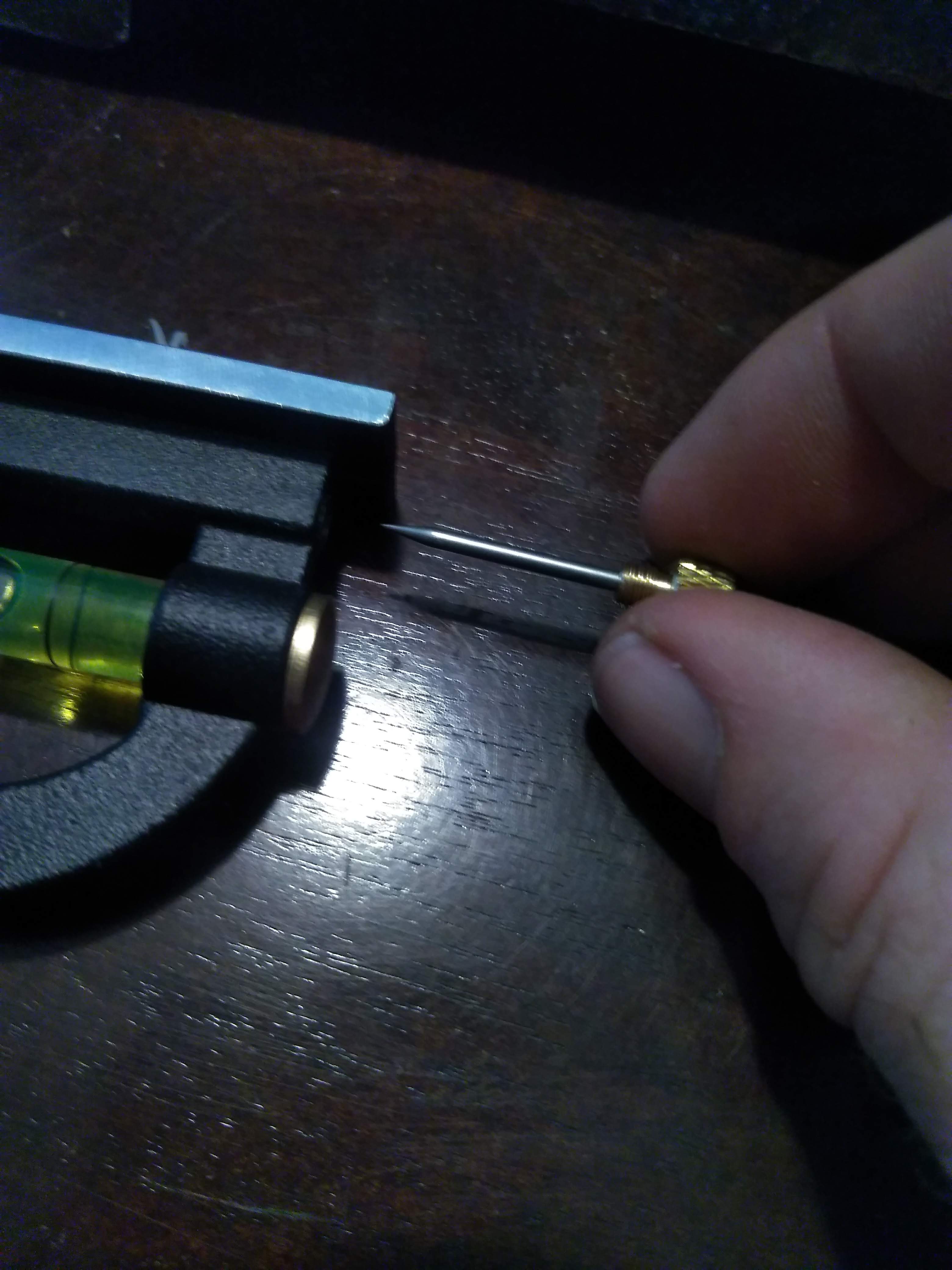

using a scribe, make a reference line to work off of. most carpenter's squares have a small scribe in the end, or you can use a sharp piece of tungsten.
when making your reference line, try and choose a machined point, in my case, I used the top of the bolthole for the lower bolt of the flange

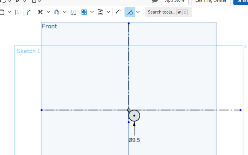

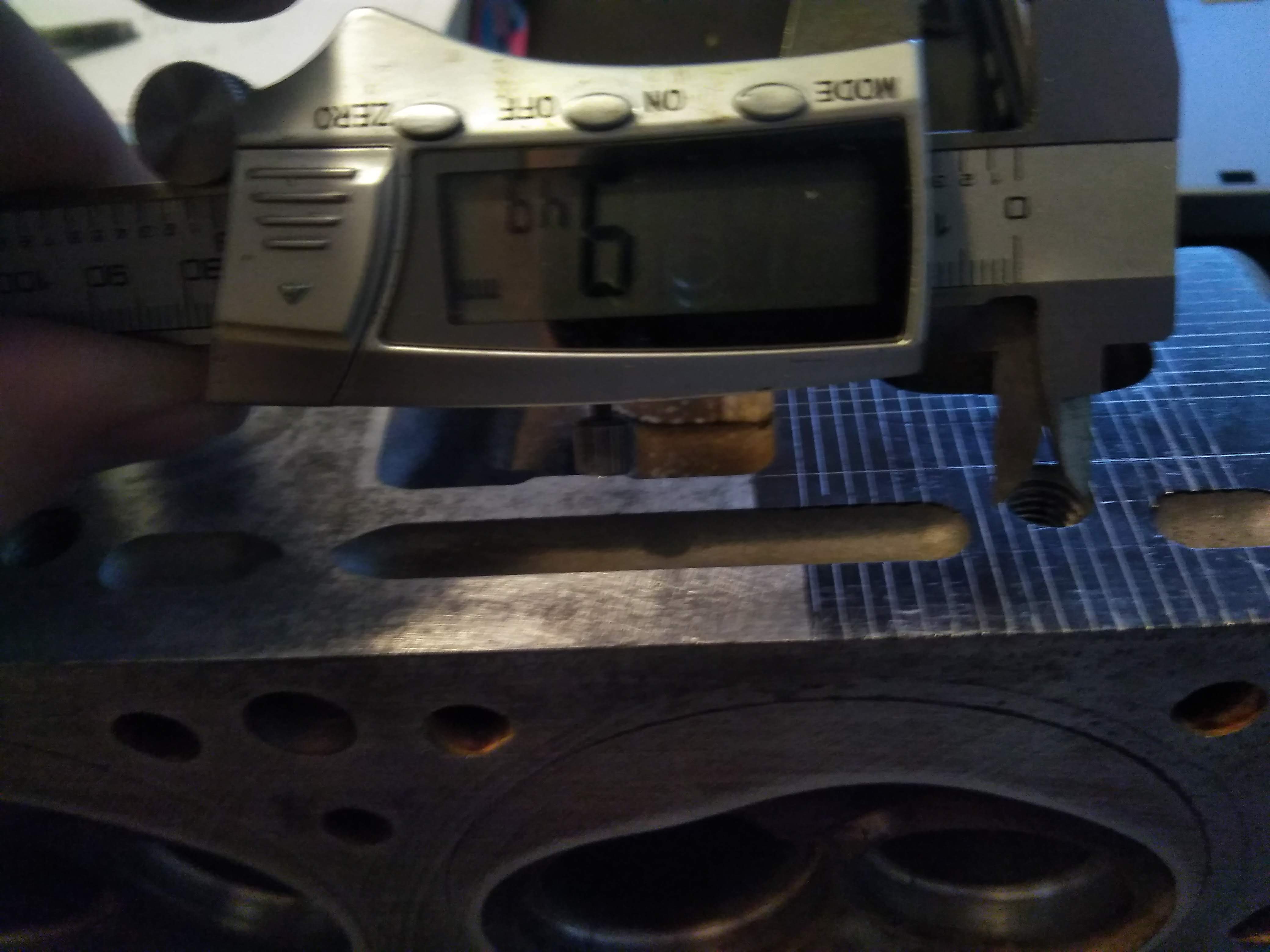

now, I know the axis for my measurements are tangent to the bolthole, so I can measure the diameter of the hole, as well as the distance to the other hole and put the holes in the drawing,

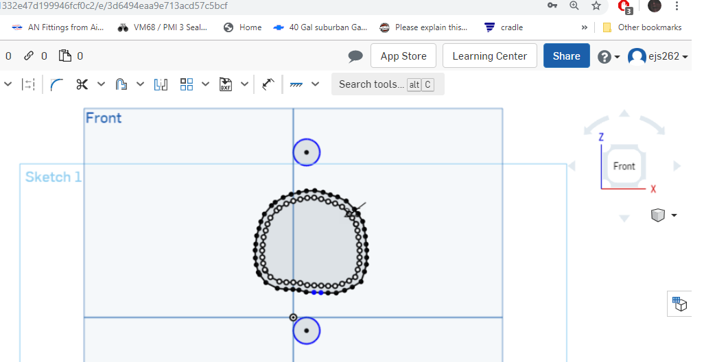

next is the tedious part, we measure the port, from the reference lines, at each point, and plot it in our drawing. the more accurate data points you have, the more exact the flange will be.
once that's done, you can clean up the drawing leaving you with something resembling a port, connect all of the points to close in the shape.
proper port shape and position is important, if the flange overlaps the port, it will be a significant restriction to flow, if the flange is grossly oversized to the port, you'll lose velocity coming out of the port. I oversized my ports by about 10%, this ensures that any variances in the casting won't result in the flange overlapping the port, without being grossly oversize like the BCC flanges. I did this by using the offset tool in OnShape, and offsetting the port by 1.5mm, which creates a new set of points 1.5mm out from their original position, resulting in a port about 3mm wider and taller.

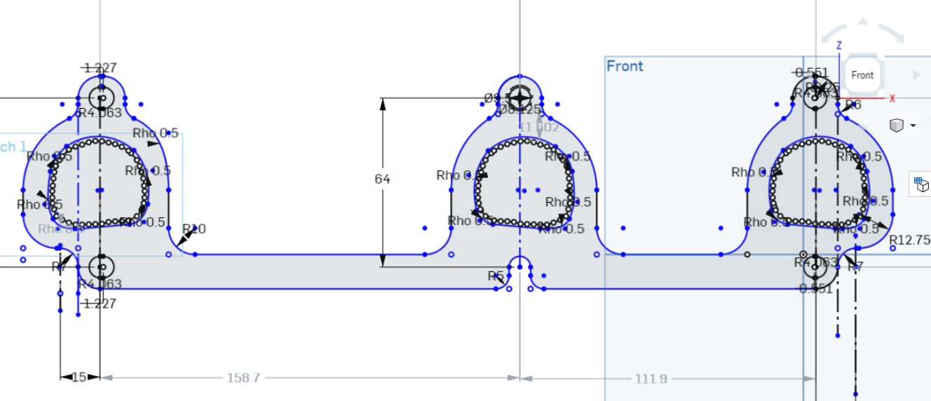

if you're lucky, all of your ports are identical, and you don't need to remeasure each one, just copy and paste, if you're slightly less lucky. one or more of the other ports are a mirror image of the existing port, and you have to flip them, if you're really unlucky, rinse and repeat for the other ports. either way, the next step is to do the other ports, in my case, I measured the distance between each port, copied, pasted, and then copied, flipped, and pasted. then I traced out what I want the finished flange to look like.
if you're better than me, all of your measurements will be spot on the first time, and you'll be ready to have it laser/water cut and start welding, but a smarter option is to have the flange 3d printed first, to verify fitment.

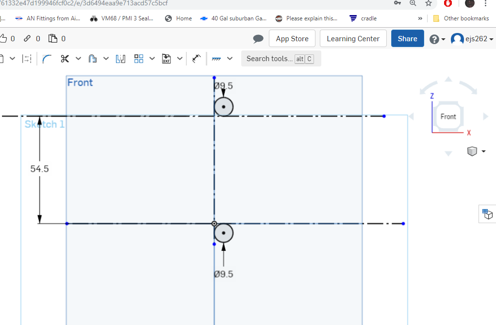

Oops... I used dimensions for the bolt spacing from an older drawing and assumed I had measured them correctly...
new measurements, new result! now I can easily see the small changes that need to be made, and make those corrections accordingly.
now that you've verified everything is satisfactory, you can have the flanges cut from whatever material you see fit. in my case, I chose 304SS, to match the weld el's I'll be using for my manifold.
something of note, because I am using weld el's with my flanges, they won't be fitted to the inside of the ports like you would normally see with headers. in this case, the port has the same perimeter as a 1.5" OD pipe or tube forming a pipe or tube to that shape may result in the pipe intruding into the gas flow, resulting in poor performance, so enlarging the flange further may be necessary to optimize performance. this technique will likely work in other applications, but will probably not be very effective for OHC engines, as the ports usually aren't in an as easy to measure position. I have hopefully one last revision to print, and I'll be ready to cut the flanges in something a little more permanent.

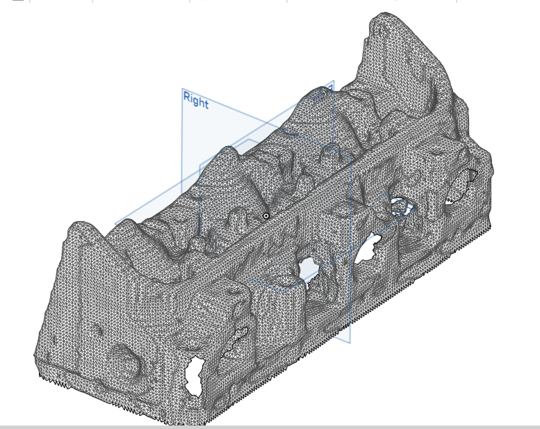

I in no way tried to imply this was the only way to do it, I don't have a scanner, and don't need one frequently enough to consider purchasing one ATM. I did this using only simple hand tools, illustrating that it can be done by anyone with patience to measure the parts. I actually have a consumer grade 3D scanner, but it doesn't produce very high quality results, that may be in part due to technique, material, or the scanner quality, I'm really not sure, I haven't used it enough to prove anything.
Originally Posted by 83 Crossfire TA
There is even smartphone "scanning" software that will do a lot of this for you using your smartphone camera, but except for a couple of emergency "I need this now," situations I can't bring myself to trust some smartphone software for something that I'm going to be doing a lot of work based off of.
In my experience, the method I illustrated above is not only more accurate, but also easier than the smartphone apps, I took hundreds of pictures to render this gelatinous blob....
