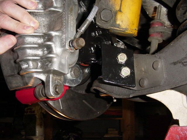

Old Aug 24, 2020 | 05:30 PM
92Z's Avatar
92Z
Posts: 278
From: KS
Re: Bump stop modifications after LS1 brake upgrade
I saved this pic years ago. Maybe helpful to you.
Old Aug 24, 2020 | 08:09 PM
babyduck's Avatar
Joined: Oct 2018
Posts: 15
Thanks. I finally did about the same thing on the driver's side. The passenger side was fine by a hair
Old Aug 25, 2020 | 05:25 PM
dixiebandit69's Avatar
Joined: Sep 2007
Posts: 397
Likes: 43
From: The ******* of Texas
Car: '89 Firebird Formula
Engine: TBI 305
Axle/Gears: 10-bolt, 3.42s, Torsen diff.
Does the steering-stop still make contact with the caliper, or does it hit the bracket?
Because if it hits the caliper, it will push the pistons in on really tight turns, and reduce your braking performance for the next couple of pedal applications.
I noticed this in parking lots shortly after installing the kit on my car (before I modified the stop).
Ex: I'd back out of a tight parking space, and the next time I stepped on the brake, the pedal went to the floor. It took me awhile to figure out what was going on.
Back from the dead, need ideas for a steering stop.
Old Dec 2, 2020 | 11:45 AM
//<86TA>\\'s Avatar
iTrader: (15)
Joined: Aug 2006
Posts: 12,813
Likes: 110
From: Central NJ
Car: 86 Trans Am
Engine: 408 stroker sbc
Transmission: TKO600
the picture above looks like it would work.
Think it's hitting the caliper bracket?
