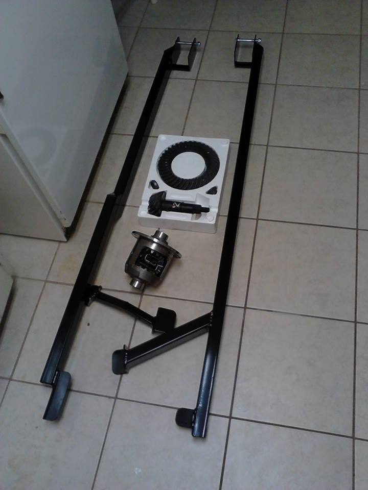

These are the subframe connectors as I received them. Disregard the ring & pinion gears and the limited slip differential, those went on a different car.
Here are the same subframe connectors after they have been modified by me. You can see the pathetically small passenger side brace next to my welded-in custom brace on the left, and you can see where I added to the bracket on the right.

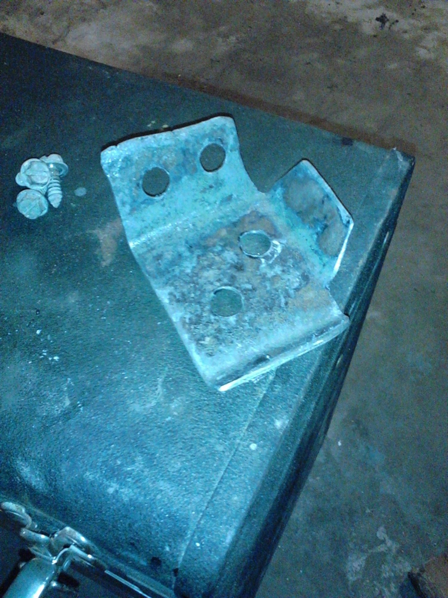

When I test-fit these connectors, I knew that there would be a lot of custom work required. Right here, you're looking at the front-left SFC mount. It's made out of really thin steel, and this is what the SFC is supposed to be welded onto. Note the oval-shaped hole; this is where one of the welds SHOULD be.

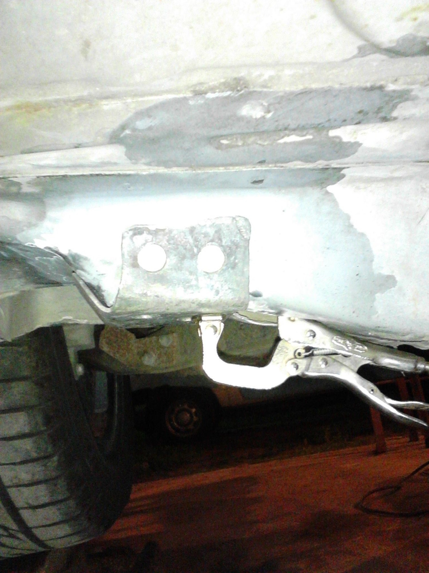

I could have just welded the SFC bracket on one side, but it wouldn't be as strong, and it would probably crack. I had a better solution...
I welded in a plate to spread the load out. Those pock marks you see in the middle of the plate are rosette welds; I drilled holes in the plate and welded them up.
Keep your eye on the bottom of that oval hole.

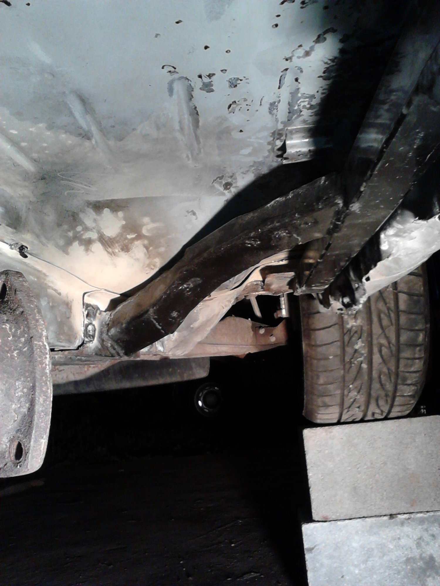

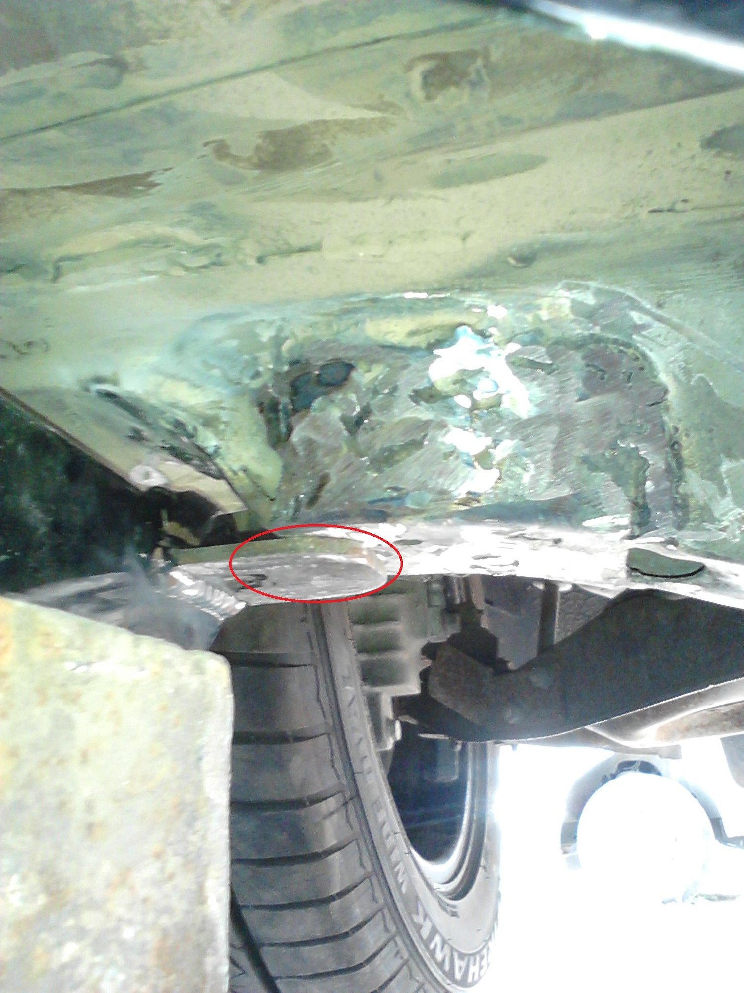

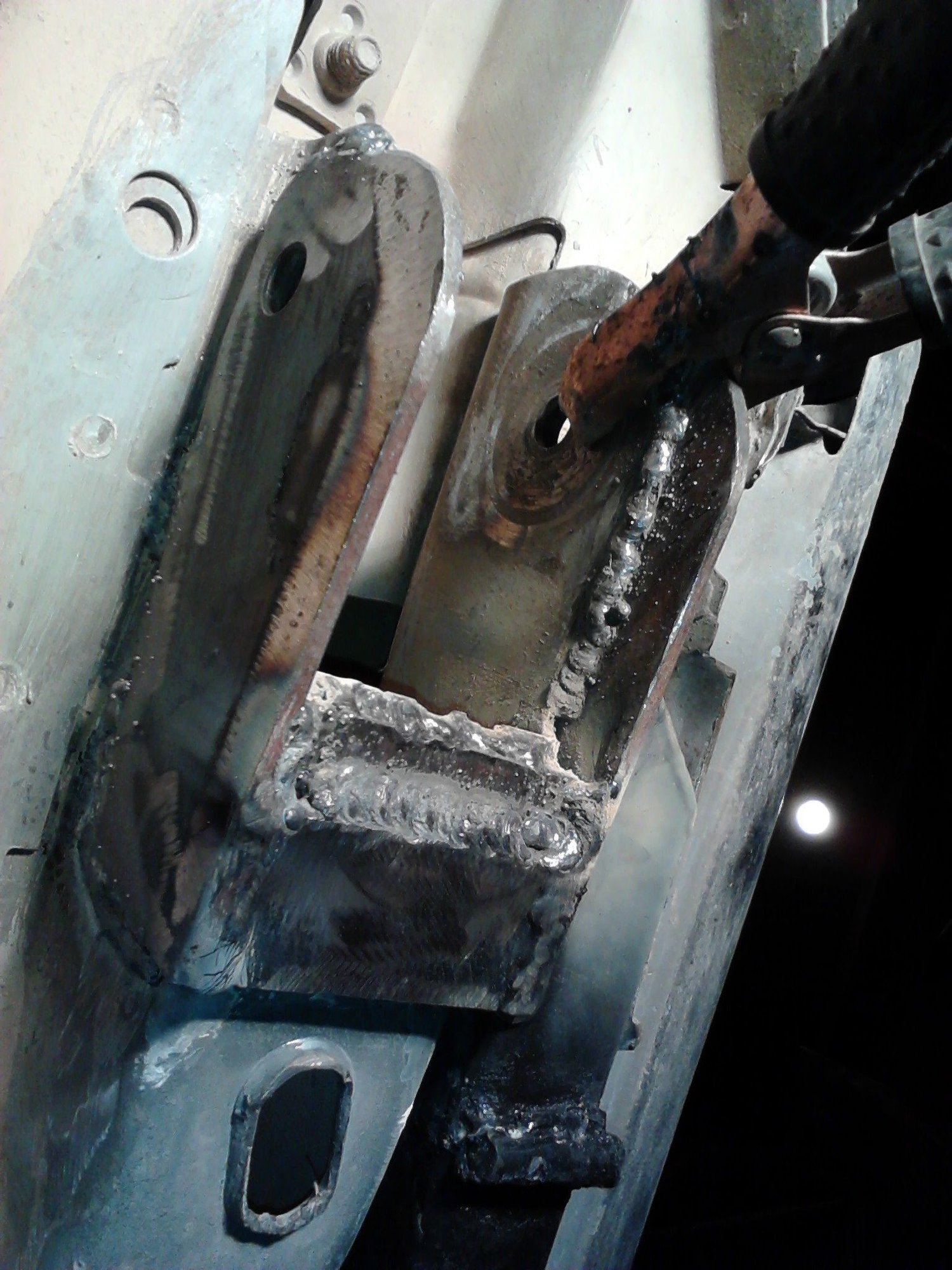

Here's the right-front SFC welded in. The circled area is where the oval hole was. I wouldn't have been able to use any of that area if I hadn't welded in that plate.
Also, note that I ground some material off of the side of the tab; this was to clear my exhaust system (a muffler-shop job, 2.5" into a single 3").
As you may have seen before, the front of the subframe connector kit I got wasn't up to par, in my opinion. On the driver's side, it would be "connecting" to another really thin piece of stamped steel. In my opinion, that was not strong enough, so I reinforced it. I cut and bent some 1/8" steel, drilled some holes in it, and welded that in.
Here's the steel plate I welded in. The holes drilled in it are for rosette welds.
Even with that plate welded in, there is another problem: The subframe connectors only connect to the car with this one little tab!
I know why the manufacturers did this: To allow for manufacturing variances, and for body-flex (after all, these cars are over 20 years old.).
But that's not good enough for me...
EDIT: You can also see the 7/16" round stock pieces that I welded onto the bottom of the SFC; this is to keep the jack in place when I lift the car and keep it from sliding off.

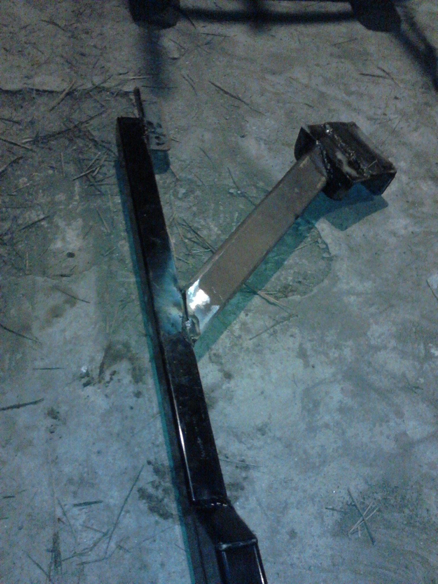

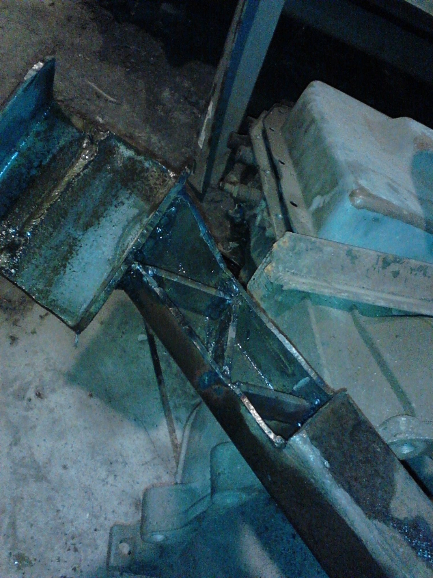

I welded some tabs of 3/16 steel to fill in that gap. I welded it for 3/4 of the way. I'll provide better pictures of the installed product later.
This is the passenger side subframe connector, with my added on connector/arm. The added on piece is 2"X2" 3/16" square tubing that I had laying around my shop.
Here is a different view; that section on the left is cut out to clear a dip in the floor-pan.

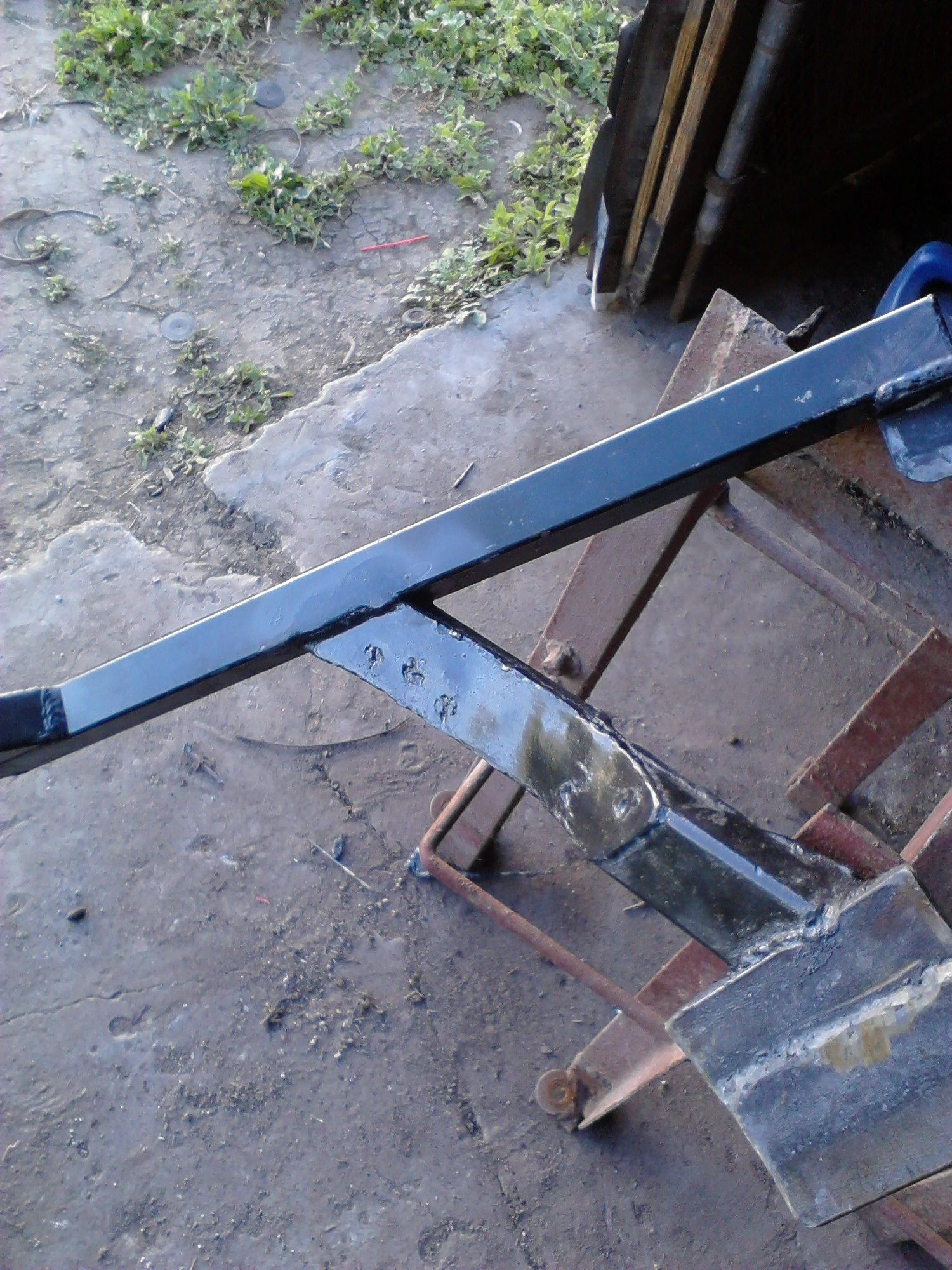

Here is that same 2"X2" piece of steel installed, after all of the trimming for exhaust and floor-pan clearance! Looks kind of flimsy, doesn't it?
Wait until you see what I did with it next.
I had to cut out sections of the 2"X2" tubing to allow for floor-pan clearance, and for exhaust clearance. But I gusseted the inside with 3/16" steel tabs. Then I welded a plate over it.
Additional view of the gusseting I welded in; this is the top side.
Here's what the finished product looks like, with the patches welded in and painted.
Bottom:

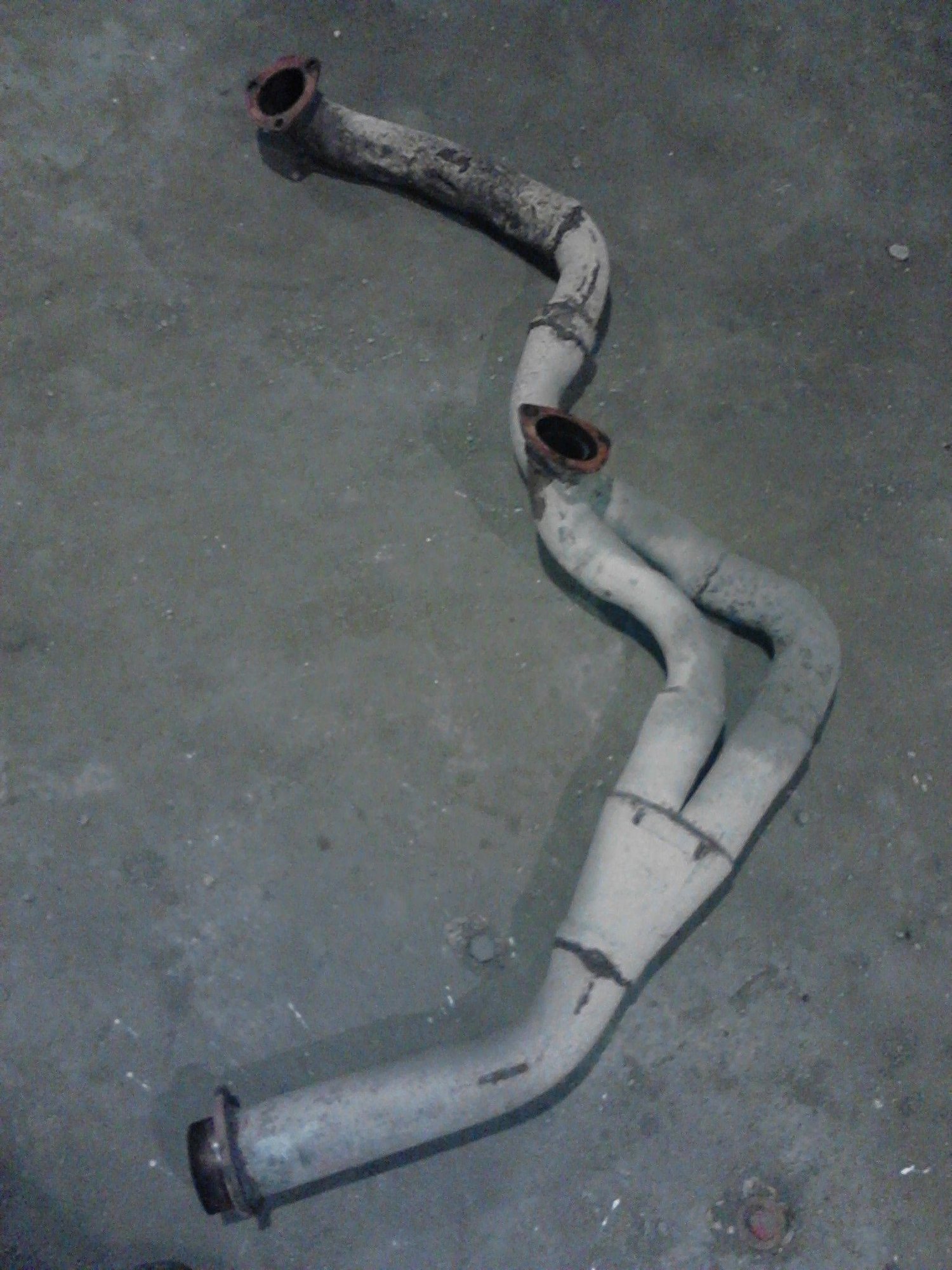

Edit: One last thing I forgot to mention: I'm pretty sure that the exhaust Y-pipe is hitting the passenger side connector, even after the grinding; on some bumpy roads, I hear a clunking/banging coming from that area.
Even with the material I removed on the mount, it was still a VERY tight fit.
I plan on making a new y-pipe as soon as I get some more money and time.
Here's what I'm running right now, shown off the car:
