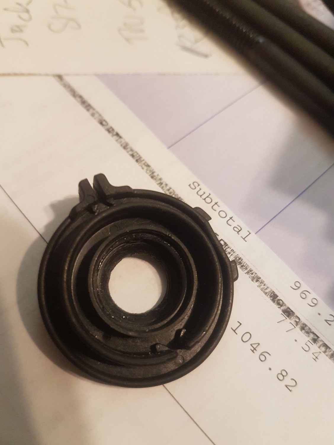

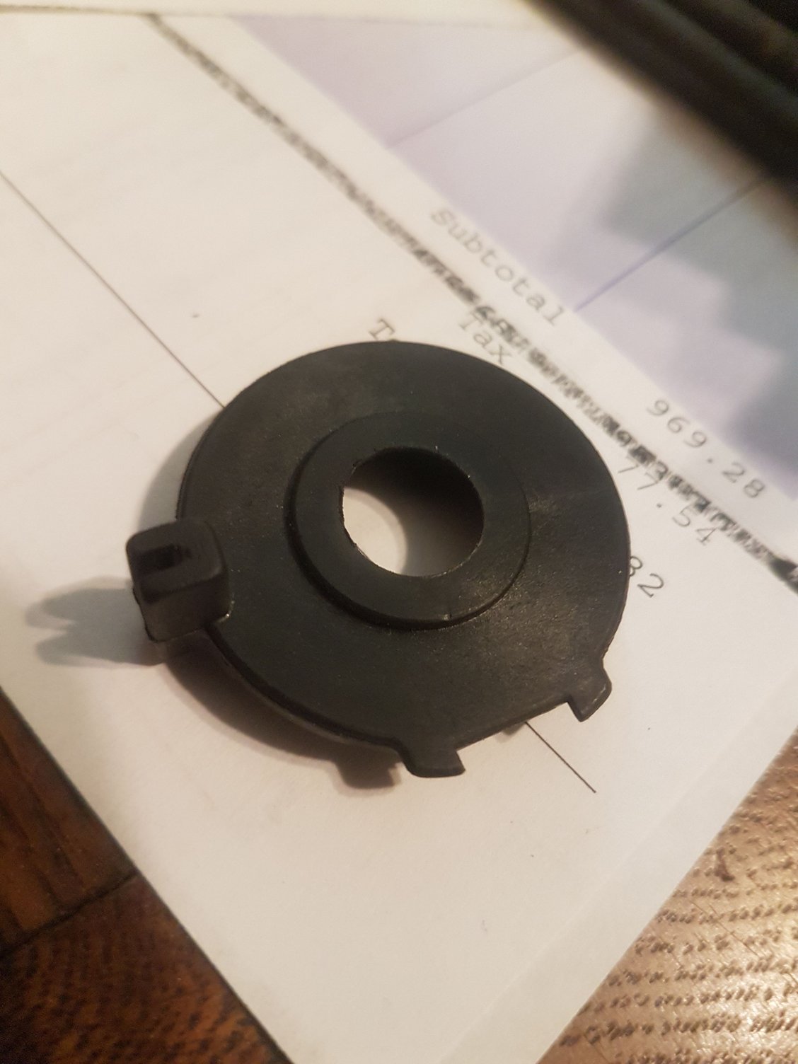

First off I know zero about this art of 3D printing/scanning I have an Accel Throttle body that had some of the plastic what I will call "Washers" one is missing and other is a little melty around the edges good news is I have a NOS throttle body with new parts I'd like to get scanned and I cant find anyone local or reasonable to do this they are like 2" in OD and maybe 3/8" in overall width. Long story short is anyone willing to help me scan them?

Do these look good for training?

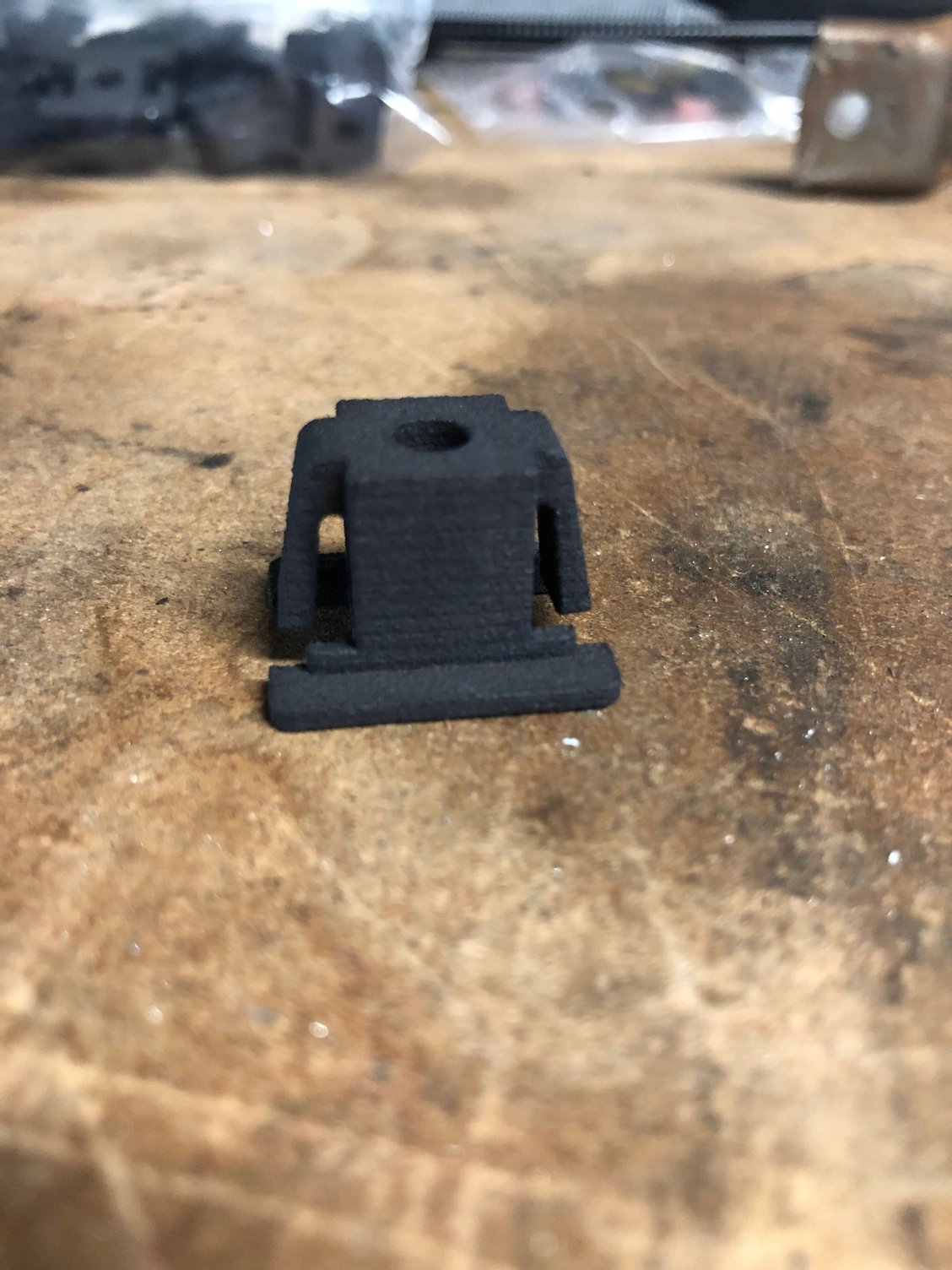

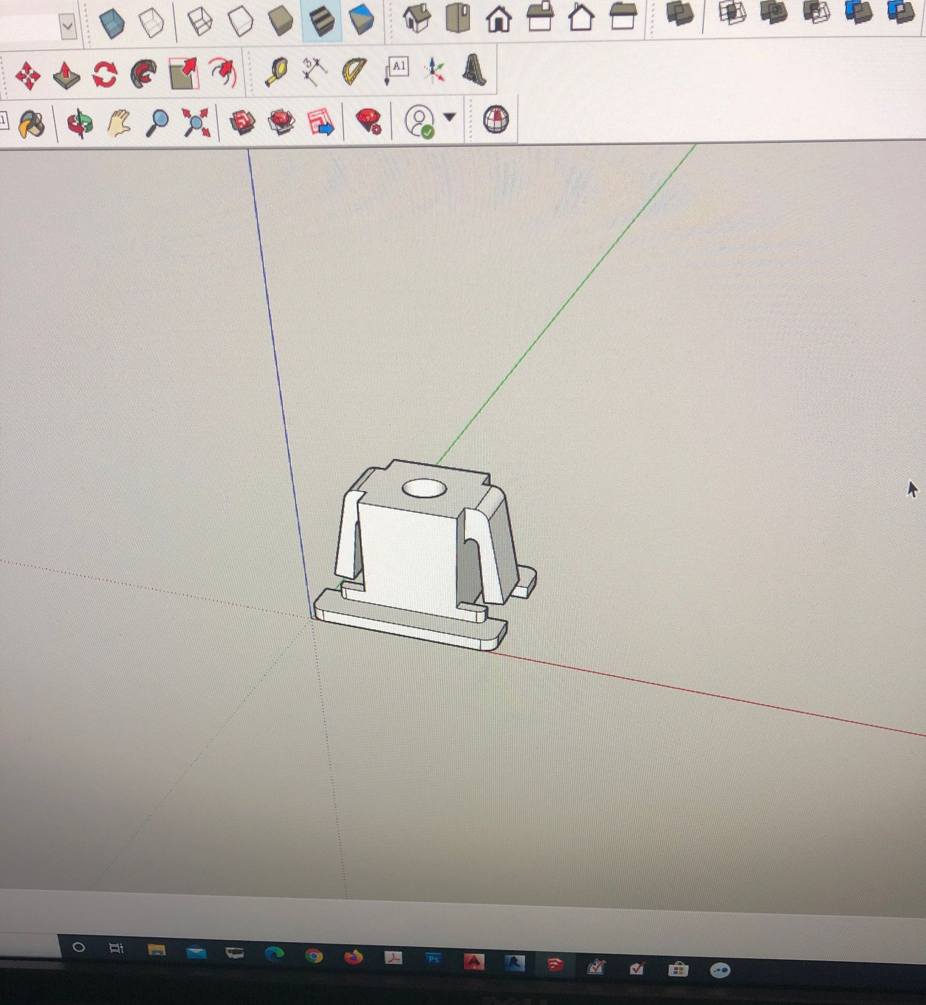

i've had good luck using Sketchup to model parts. you can export an STL file and have someone print it for you. from what i've seen, modeling the piece is the time consuming (expensive part) of having something 3D printed. if you are able to provide a file to print from, things get much cheaper. i recently modeled a non-A/C heater box nut because mine were broke and i couldn't find replacements anywhere. turned out pretty good. first picture is the part in Sketchup and the second is the actual 3D printed piece.
