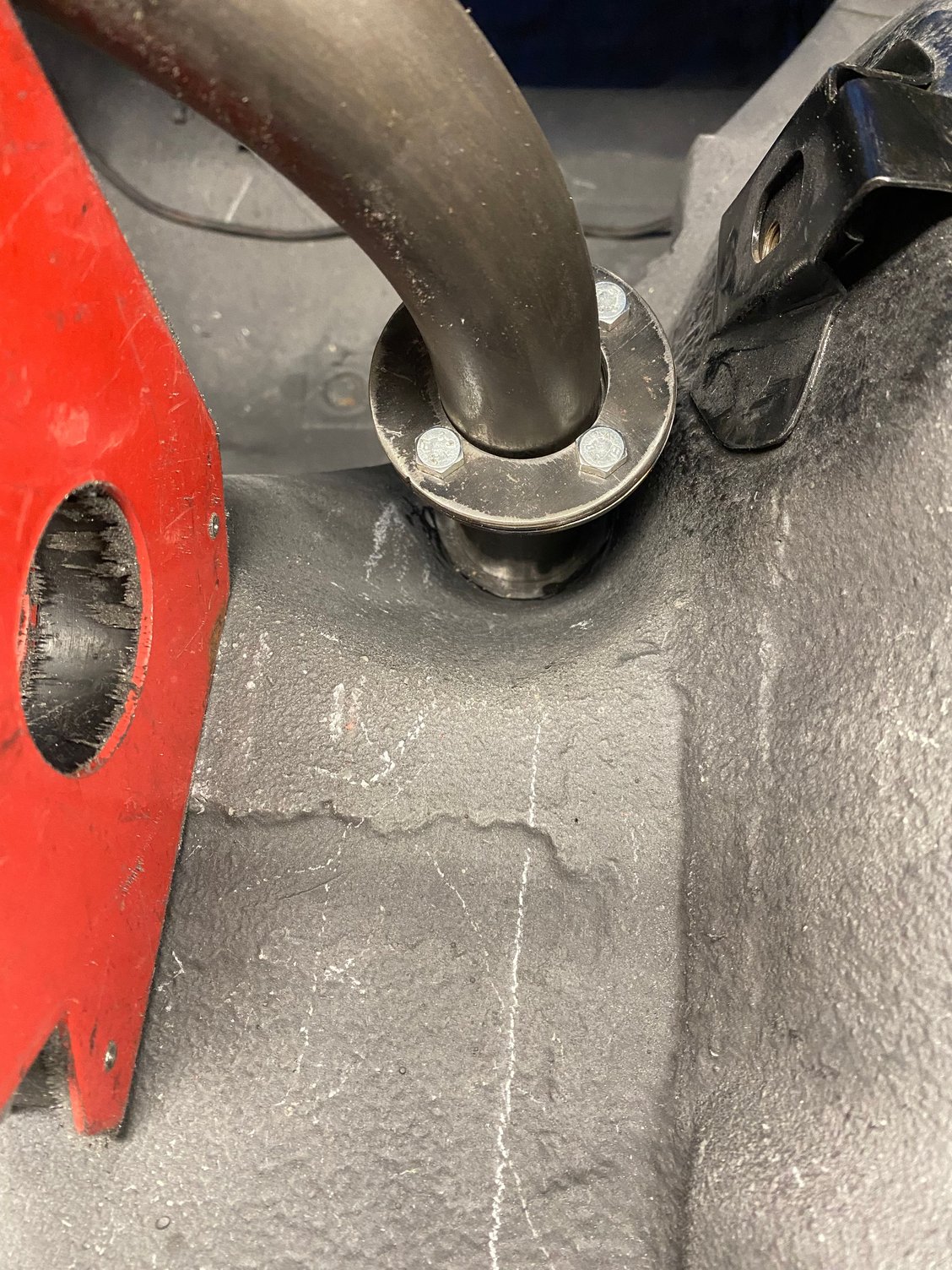

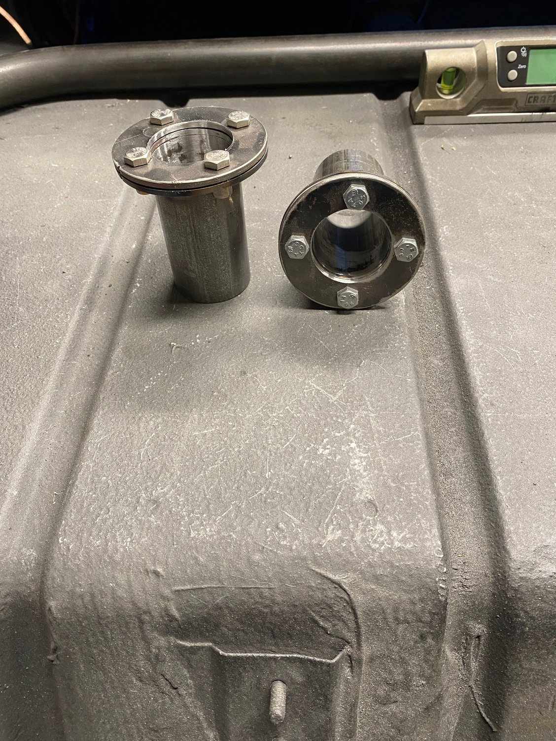

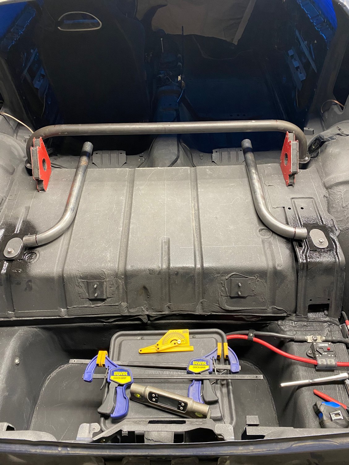

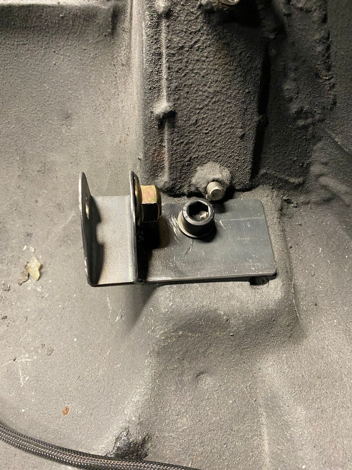

I’ve decided to delete the rear seat and add a harness bar to compliment some new Corbeau RRX seats. I took some pictures along the way to document the fabrication. It is a bolt in unit to receivers that are welded to the upper rear shock mount pads. I can do this because of the C4 suspension that is in my car, which eliminated the Camaro rear shocks. I hope you enjoy it.
Receivers for the cross bar

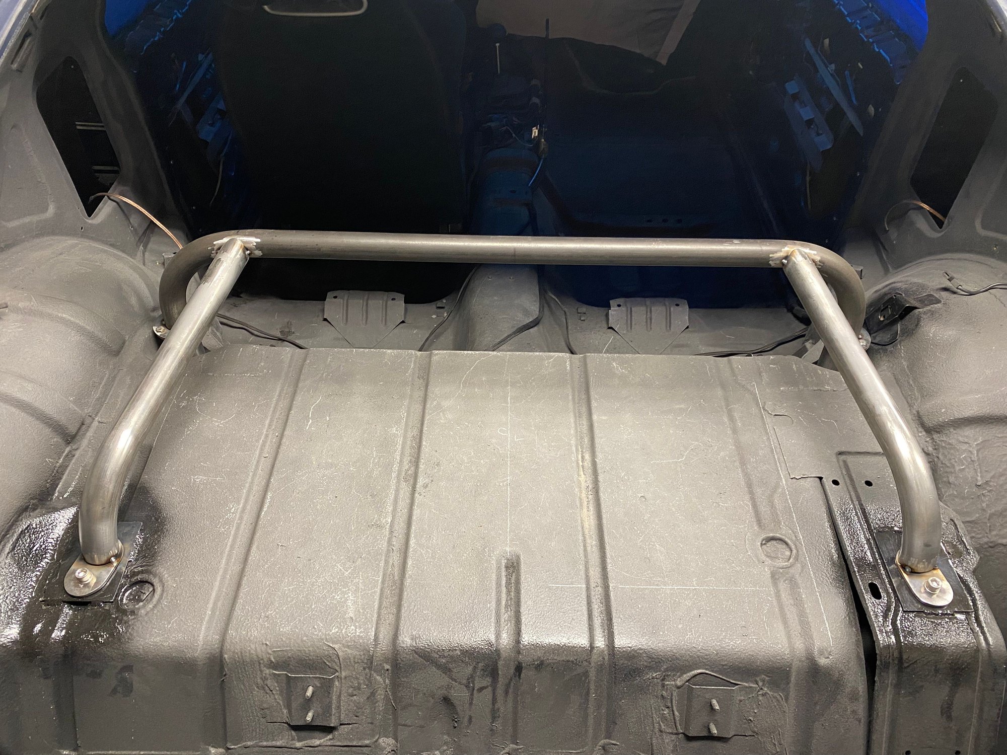

Cross bar mock up
The carpet will cover the receivers like the original foam fillers

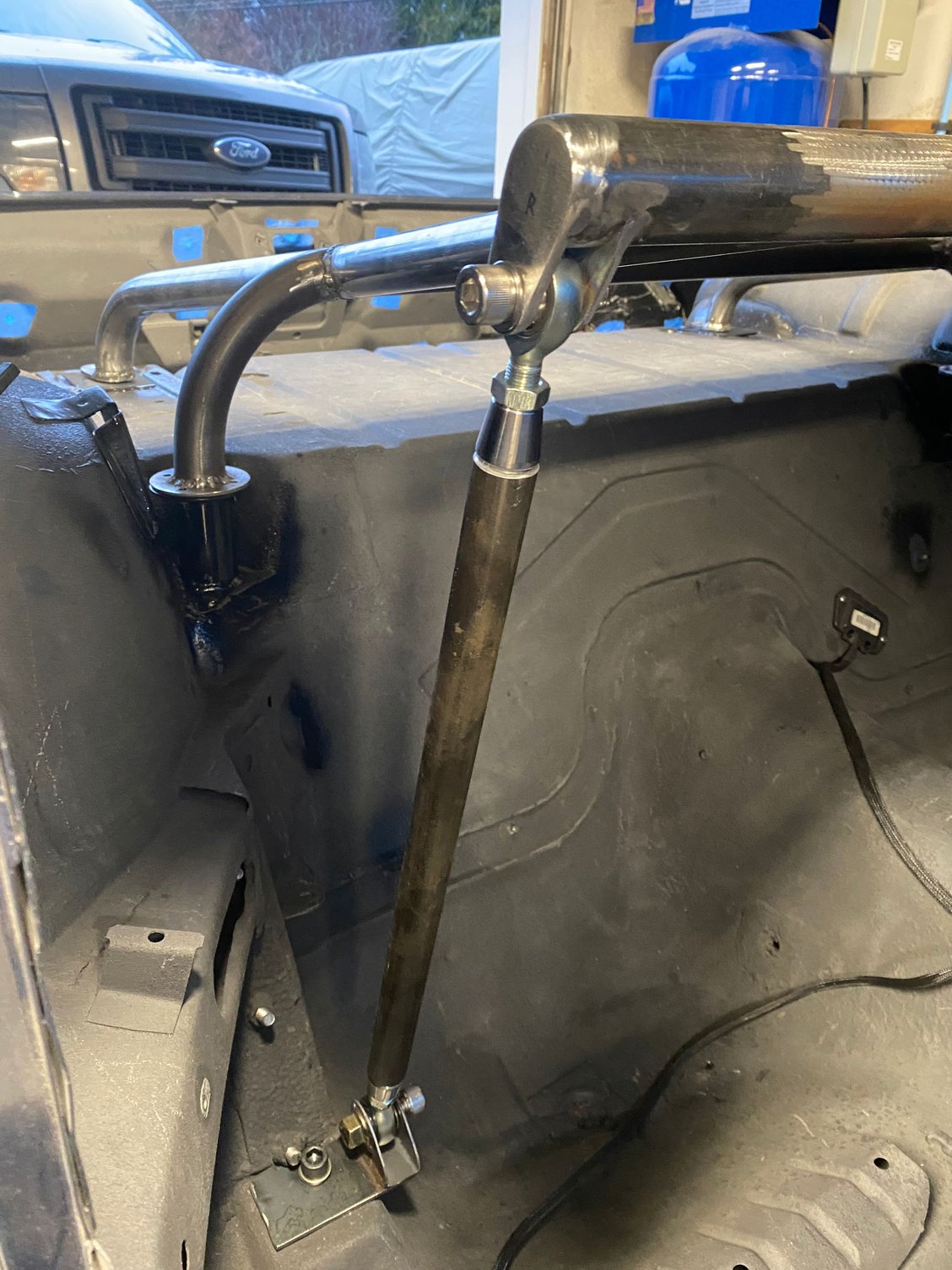

Lower down bar brackets bolt to the rear seat belt pad

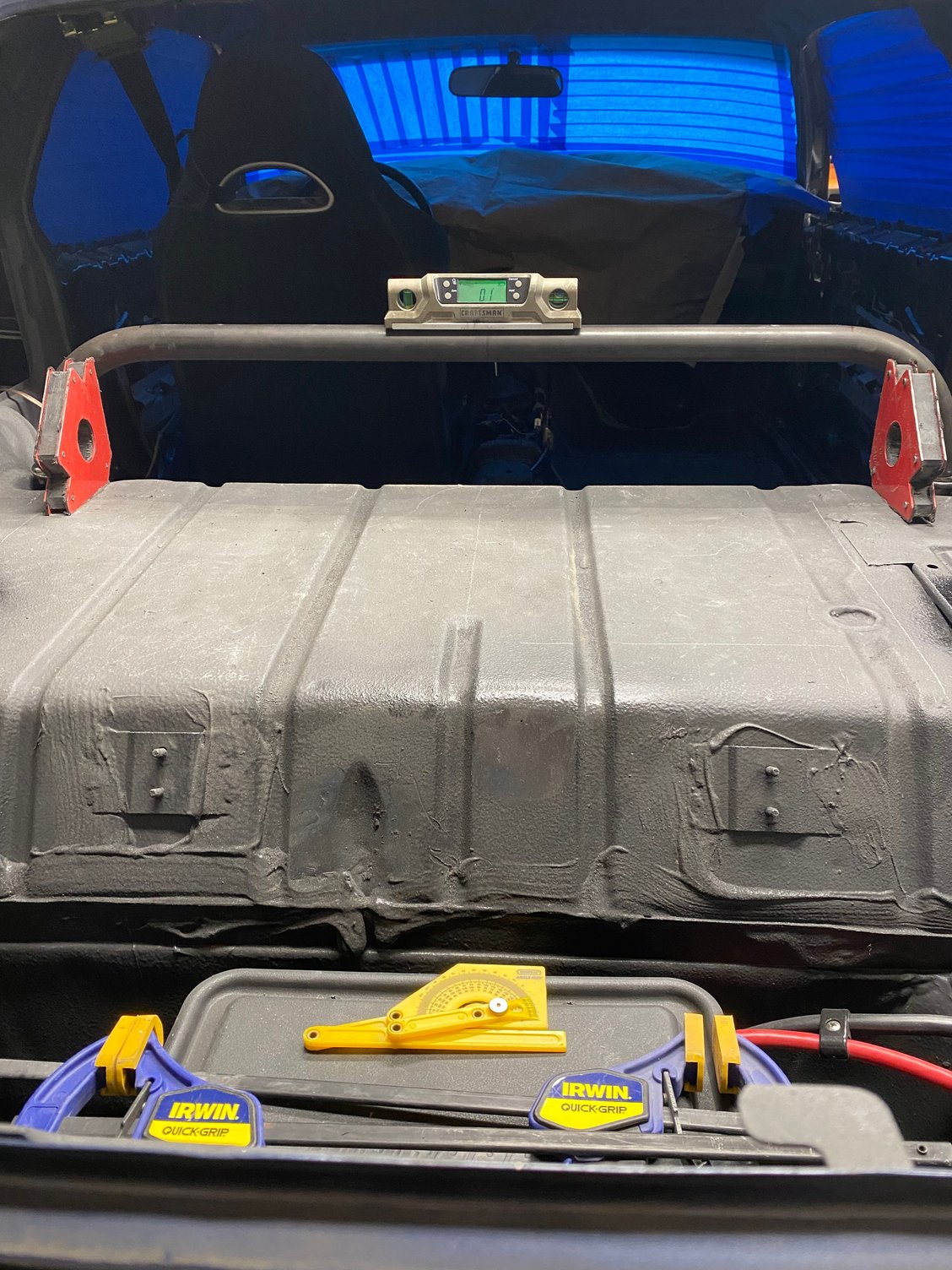

Mock up of the rear outriggers. There are pads welded to the rear deck.

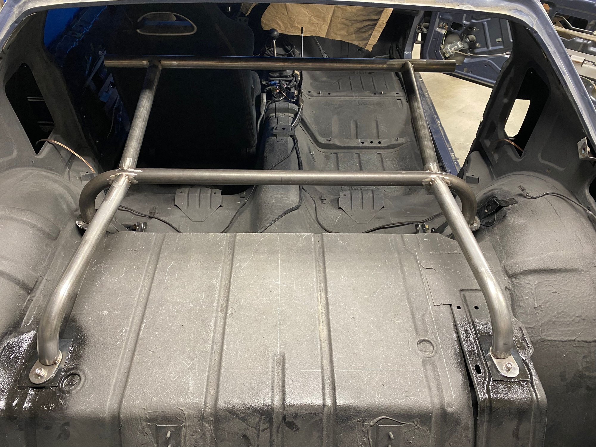

Rear half of the unit tack welded in place
The harness bar will “float” just behind the seats at shoulder height with the attachment bars centered to evenly transfer the load to the cross bar.
Down bars added to transfer additional loads to the floor.
