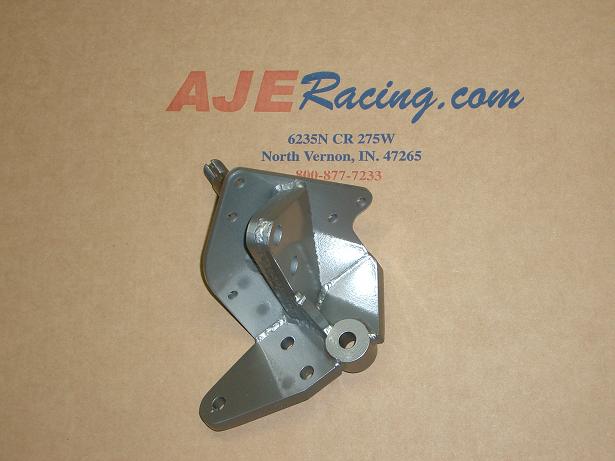

Great news here! I just got off the phone with Anthony Jones of AJE Racing Ent. He is stating that the Dropped Spindles will go into production around the middle of March - Hurray. It's been a long wait, and search, but the spindles are on their way.
What we are going to wind up with is a Dropped Spindle (1.8" drop) that will accept our stock/OEM struts, steering, and brakes. For those of us that want to use the LS1, C5, or C6 braking systems - because the stock/OEM caliper mounting holes are smaller, and this smaller size is what they will be produced with, we will drill out the holes to 12mm x 1.75 for the caliper mounting brackets, and be able to add a backing/lock nut on the reverse side for extra strength, or security. These spindles actually are stronger than the stock/OEM spindles. All struts, including some of the racing strange struts will fit... Stock/OEM steering will fit.
These struts are also lighter by 3.5 lbs over the stock/OEM strut, and made of better/stronger metal, and with the weld filler material/process the tensile strength goes way up also.
Anthony says he has produced his spindles for over four years now with no problems. Even with 10 second, wheel standing, ground pounding, monster cars. Some of these cars were even Mustangs - but we can forgive him for those...ha, ha.
So I hope for all this is great news - I know I have waited a long time for them...~Ed~

When can we see exact brake mount diagrams. Before I am will to say I am for sure, I NEED do know my brakes will be workable with this setup. Since the 1LE spec modifications, use 1 of the dust shield holes, Knowing and seeing the exact mounting of the brake system is a must for me, before I buy.

The OEM/stock hole location is the same for standard brakes, 1LE system, LS1 system, C5, and C6 - only because there is a size difference, stock/OEM brake mounting holes being the smaller, that is what the spindles will come with. We then can drill & tap to a larger size on these existing holes for our different systems...See attached pic. of the 1LE high performance upgrade...same holes on all. Instead of drill&Tapping the 3/8"x24 UNF, we will go with the 12mm x 1.75 - The holes are there we just need to enlarge them...If we were able to get the old Bell Tech p/n 2200 Dropped Spindles we would have to do the same thing, and maybe more...
~Ed~

I know, but in the pictures a couple of pages back, they was not the cutaway near the ears. With that cutaway, the brackets and calipers will not clear properly.

Why not? Mine clear, as does all who have upgraded to the bigger brake systems
If one had the Bell Tech Dropped Spindles how would one mount the 1LE, LS1, C5, and C6 if they didn't fit?????

Notice it is a solid plate. It is not shaped at all like the stocker is. So long as I can verify that the spindel will work with my adaptor plate, and brakes. I am all for it. But the pictures provided, look like the mounting would be no where near what is needed for the aftermarket kits.
Hopefully they will provide is more detailed info on the pieces going into productions. Since they are already at the production stage, it is not unreasable for them to have a finished prototype. I hope they would post pictures, and more detailed specs, before we all commit to paying them.

The LS1 Hub assembly is a mute point, as they will not fit any way - The strut mounts are in the way...~Ed~

Is the steering arm still for the rack system? How is the standard steering linkage going to be fitted?

I am going to contact A. J. in the next day or so to see when production will start. hopefully soon. I do remember when we at TGO made a group purchase for some 9bolt Girdles. Six months rocked by before they were ready for sale, but it was worth the wait, they were beautiful.

The new Dropped Spindles will have adaptors that will make them ready for our standard steering, or without the adaptor for Rack & Pinion, which ever one you want.

So you can get them to work with stock steering, or with a rack? I wonder if it is possible to get one with BOTH options. I'm going to be using the stock steering, but my kmember is set up for a rack. It's just going to be a while before I get a rack...so both options on the same spindle would be nice..for me anyway.

I am still waiting for a more defined answer on the brake mounting. They don't seem to be very forthcoming with information.

The Dropped Spindles will handle our stock steering with the OEM Steering adaptor. If then you take off the steering adaptor one can use a Rack & Pinion Steering with the same dropped spindles...So again, use either system with this Dropped Spindle.
On the different brake set ups it will be like OEM/Stock spindles. The holes are there but they will need to be drilled larger for the different brake systems. The holes are made for the smaller sized OEM Brakes, or 1LE. To adapt for the LS1's, or C5's,or C6's the hole is enlarged to the approperate size. This has been stated a couple of times before.

This is the way I understand it - They are custom built to mount the 1LE type brake systems. Because the other brake systems use larger mounting bolts/hole sizes, the spindles are pre drilled for the 1LE,or the smaller size. (i.e. one can always go to a larger size, but not visa-versa). I'm hoping to be in contact with Mr. Jones on Monday to see when production will begin ...Soon.

Man, that is perfect!!! I can use my gearbox for now, my rack later, and pretty much any brake setup. Perfect!!

Our Dropped Spindles for Third Gen cars is definitely under way. Anthony Jones is getting all setup to start production in the next four to six weeks. Machines are being set-up, and materials are being ordered. When production starts a 50% down for the order will be placed, and then the final amount to be paid at shipping. Soon, soon we will have them. It's been a long road of searching, and talking to many manufacturers, but finally they are going to be the real thing.
There have been many questions about the different braking systems that we use. These dropped spindles are not going to be any different than if we found a set of the old Bell Tech Dropped Spindles. We can use stock/OEM brake systems, also known as the 1LE system. For the other systems, LS1, C5, or C6 we will drill the smaller holes out to fit with our particular brake system (Correct position, correct plane). My self I'm running the LS1 system with C5 Calipers. So I would drill out the smaller holes to, and tap to 12mm x 1.75, and then mount my brake system. I would re-use the same hubs, Calipers, and discs that I have now. Another interesting thing that was discovered with these dropped spindles is that one can add backing/security lock nuts on the back side of the mounting bolt. In other words, when one mounts the adaptor plate for the calipers, make the mounting bolts appropriately longer to allow a backing nut (Allot of engineering studies tell us that two revolutions of threads beyond the backing nut is sufficient strength) - This is added security for our brake systems.
On the use of our sock/OEM steering there will be an adaptor for this use. So we can use our standard steering, or dismount the adaptor and use a rack system. So either way one can choose what type of steering system they want.

With these Dropped Spindles they will put your car at 1.8" drop in front with stock springs. With your 1 3/4" drop spring, and the dropped spindle both at the same time, that would put your car at about 3 1/2" down in front. This is close enough to the pavement to roll a beer can in front of the car. One would be going around the block to avoid any speed bumps often. Look up the word ""Slammed" in the Hot Rod Dictionary, .he, he. Stock springs in front with the dropped spindles, and the lowering springs in the back to even it up. Unless one is into a big rake in the front (High in back, and low in front), then it would be stock springs all the way around. With the stock springs, and the dropped spindles in the front then lowering springs in the back gives the car a very slight rake that is almost unnoticeable - hard to measure even. The dropped spindles put the steering geometry back to where it was supposed to be, along with better alignments also.

Drop spindles shouldnt change any geometry, that is one of the appeals of getting them. Granted any suspension/steering change should call for an alignment.
As far as scraping, my exhaust scrapes more with my drop springs than the air dam, I would still try and avoid speed bumps either way.

so you would need an alignment again, and 2" should be 2" whether it is springs or spindles. But with spindles you dont lose the strut travel

with springs you gain negative camber when lowering. With spindles you retain factory camber settings. It may be possible to correct the lowing spring camber with camber/caster plates, I'm not sure though. But this is good for anyone who has thought about lowering but don't want to mess up the suspension.

It also lets you retain your stock bump-steer geomitry, along with stock roll-centers...
