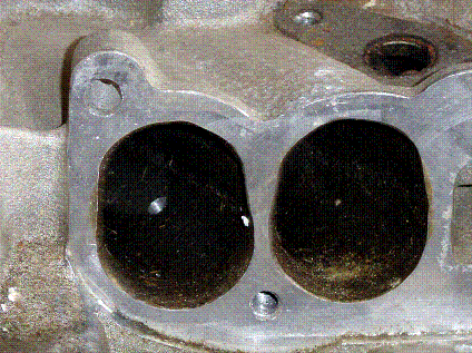

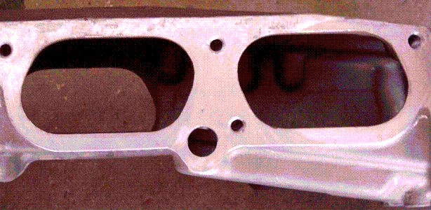

I got pics of everything ,even the casting numbers and direct comparisons to stock runner and base(ported)
Pics wont be up until later or t'row, I have to figure out how to transfer and size them appropriately.
Asking official moderator permission to post over the 3 pic a post limit due to the fact this is a prototype intake and I have found some neat stuff on it.
Pics of:
The plenum is cast as it appears with the large openings not cut as I first thought!
Rear coolant passages in intake are used, water runs down the center and connects the front to the rear of intake!(not 100% sure, but they way the rear crossover passages curve it appears to be the case)
Is set up for vette style external egr or regular F body style egr.
Left and right runners are the same.
Only thing questionable as far as machine work and finishing goes compared to a stock intake is the runner end caps, where the bolt from inside the runners screws thru to the outside.
Rest is comparable to stock intake and runner for fit and finish. No porting appears done to it. Center bolt holes were modified, but it looks like this occured after it was made however.
Hopefully they let me post all the pics and maybe I can get some more answers about this thing.
If someone sees anything specific they need a photo of for ID or verification, please let me know if u know anything
thanks
Jeremy

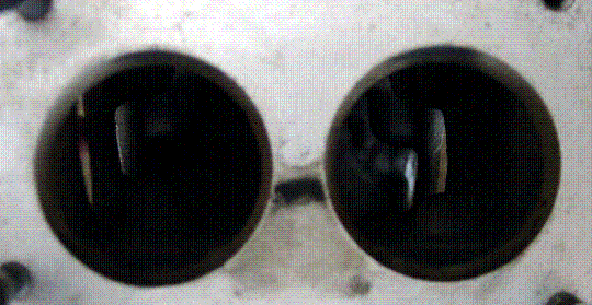

Here they are. I apologize for shape/size of some of them. New camera isnt as simple as it is supposed to be to use lol :-)

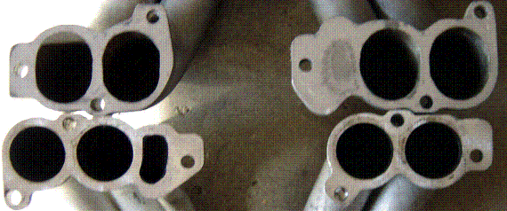

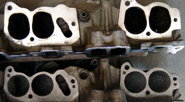

Heres some comparisons to a ported stock TPI base that I did, and a set of stock runners:

If there is any thing someone else wants/needs of it, let me know.

Its too bad the casting #s are not like the #s on a rear axle, or a door sticker. You can at least determine it is 1986ish casting.
Helpfull things to know would be:
What production plants made intakes and plenums around 86?
What different casting #s are on the regular parts around 86 and where did they come from?
What were done with the castings after they were not in production anymore?
And it looks like the intake is taller than a production one, I would think that required a different or modified mold to get that casting done.
Did you say it had provisions for the F body EGR AND the VETTE style EGR? If it does I would think it is a super Mutt. It seems to me that GM prototypes tend to be made for a specific application, and aftermarket parts are designed for more universal use. Maybe this was an attempt to make a bigger aftermarket setup for TPI cars in general (F-body and or VETTE). It could have been made by GM or someone else who had use of the molds.
This 86 base and runners should have had stock provisions for a 9th cold start injector to get it to startup ok. (unless the setup included a modified chip for cold starts)
This missing 9th injector makes me believe that It could have been made for the later model TPI cars that came without the 9th injector. Therefore it would date the parts being made around 1989ish. It is possible that GM or a aftermarket company modified the old unused 86 intake molds that were not in production anymore.
Just my .02$

I know that I have experimental runners on my 87... It was from a local company (I think Paragon) who back in the 80's was developing larger aftermarket runners for the Corvette. There about 1/8" larger dia, and they do not have the EGR tube or the cold start tube, but a place to put in the cold start injector. I think they are actually the same length as the stock tubes...
You have to think of the Runners as a musical instrument...
One of the reasons why our runners work the way they do is they create a harmonic and they like to resonate at a certain frequency. If you shorten the tube the harmonic frequencies go up, lenghen the tube and it goes down. If you make the tube larger you lower the frequency and if you make the tube smaller you raise the frequency. If you notice, many of the aftermarket larger diameter tubes are also shorter in length so somewhat compensate for a stock chip.
With that said a larger but shorter tube should resonate at the same frequency as the stock tube, but allow more air flow because of the extra volume.
Also consider that a conical (CONE) shape will alow twice the harmonic frequencies to resonate as a tubular shape, and that is exactly how your stock base plate is shaped. If you notice the ports that connect to the heads are larger in area than the round ports on the runner side. THis allows more resonating frequencies to be presant, and not have dead spots in the power curve.
What you have pictures of is an oval shaped tube. Although your allowing more volume, your harmonic overtones may become whacky at some RPM ranges because what you may create is a dual harmonic, at some RPM's it will work fine, but at other RPM's the harmonics may be dissonant enough and conflict with each other to not make it run worth a crap.
If you notice, and IIRC there are no aftermarket runners that are oval shaped, they are pretty much all round.
Its just a thought I had... unfortuantely the only way to really find out is to put it on an engine and see what happens.
Good luck

BTW, 8DE86 on the one part might mean December 8th, 1986...
What it might be is the prototype for the 89 model, I do not see a cold start injector port in the pix. And the date would be about right, 2 or 3 years from the production release.
John
John
