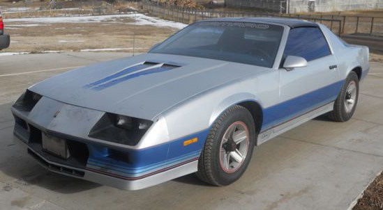

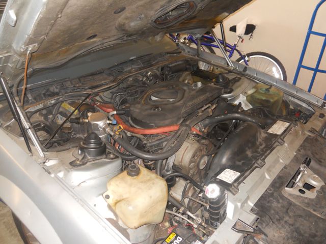

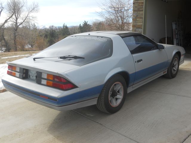

I've always wanted to start one of these threads and now I have a reason.
I picked up my dream third gen a few weeks ago -- an '82 CFI Pace Car with all factory options except the J65 rear discs. This is the car I've wanted to own since I was 12.
The car has 67,500 original miles and is bone stock. The previous owner had it since '84. The CFI is dirty but works great and is completely unhacked, which is practically a miracle. I know the CFI gets no love, but IMHO it represents the starting point for modern day fuel injection. Almost everything else acceossory-wise works (even the rear wiper) -- the only exceptions are the power pull down hatch and the power antenna.
The car spent its entire life in Florida, so the paint is shot, the interior carpet and panels are all faded so she needs some TLC. Aside from a few rust scabs on the body, the floor pans and rest of the metal is solid.
I won't be doing a 100 point, rotisserie restoration, but my plan is to completely freshen the car to take to shows and to just enjoy on the weekends.
Here are a few pics in all it's 30 year old, 165 HP CFI glory.
It feels great to have a third gen again after so many years (sold my '84 L69 Z28 back in '90). The only work I've done so far was to put new plugs and wires in. I'm already discovering how challenging it will be to find '82 specific parts (dash pads and door sills -- anyone? anyone?
Don't look for weekly updates from me, as I have a day job and family, but hopefully over the coming year I can make some progress and share the details. I'm amazed at what people here have accomplished with their restorations and it's good motivation for me.
