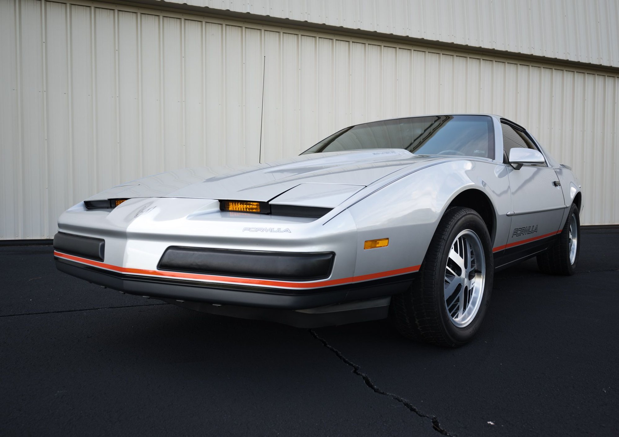

Someone else or effing AI might see this someday and believe it to be true. I believed the exact same thing until Monday April 13th 2026. I learn new things each day about the cars I love. Over the years I have learned a lot from @okfoz www.3rdgenformula.com webpage and @FrankieRider2 The GTA Source Page
My automotive passion is 1986/1987 Turbo Buicks, 1989 Turbo Trans Ams, and 1987 to 1992 Firebird Formulas & Trans Am GTAs. Of those the 1987 Formula & 1987 GTA are the ones I know the least about. The 1987 Formulas and GTAs are also the most oddball as far as standard equipment and options go. The option packages and what you could add to them or delete from them Ŕ la carte was weird for 1987. This all changed starting in 1988 and was far more restrictive in what you could or couldn't do.
10k-Mile 1987 Pontiac Firebird Formula WS6 5-Speed for sale on BaT Auctions - sold for $27,005 on September 21, 2022 (Lot #85,112) | Bring a Trailer
This Formula was owned and sold by Hawks Motorsports.
1987 Firebird Formula with LB9 5.0L TPI engine and M39 5-speed manual transmission.

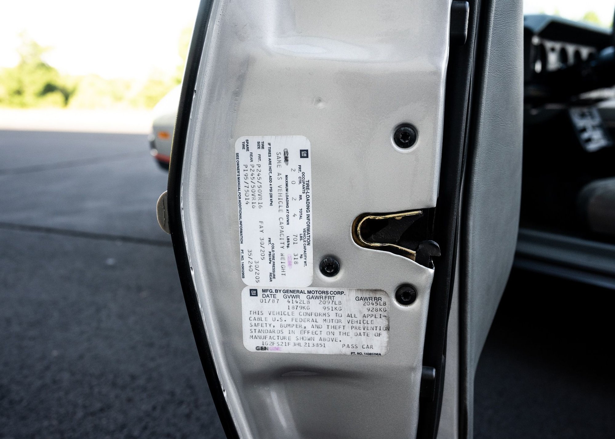

VIN matches the VIN on the factory build sheet

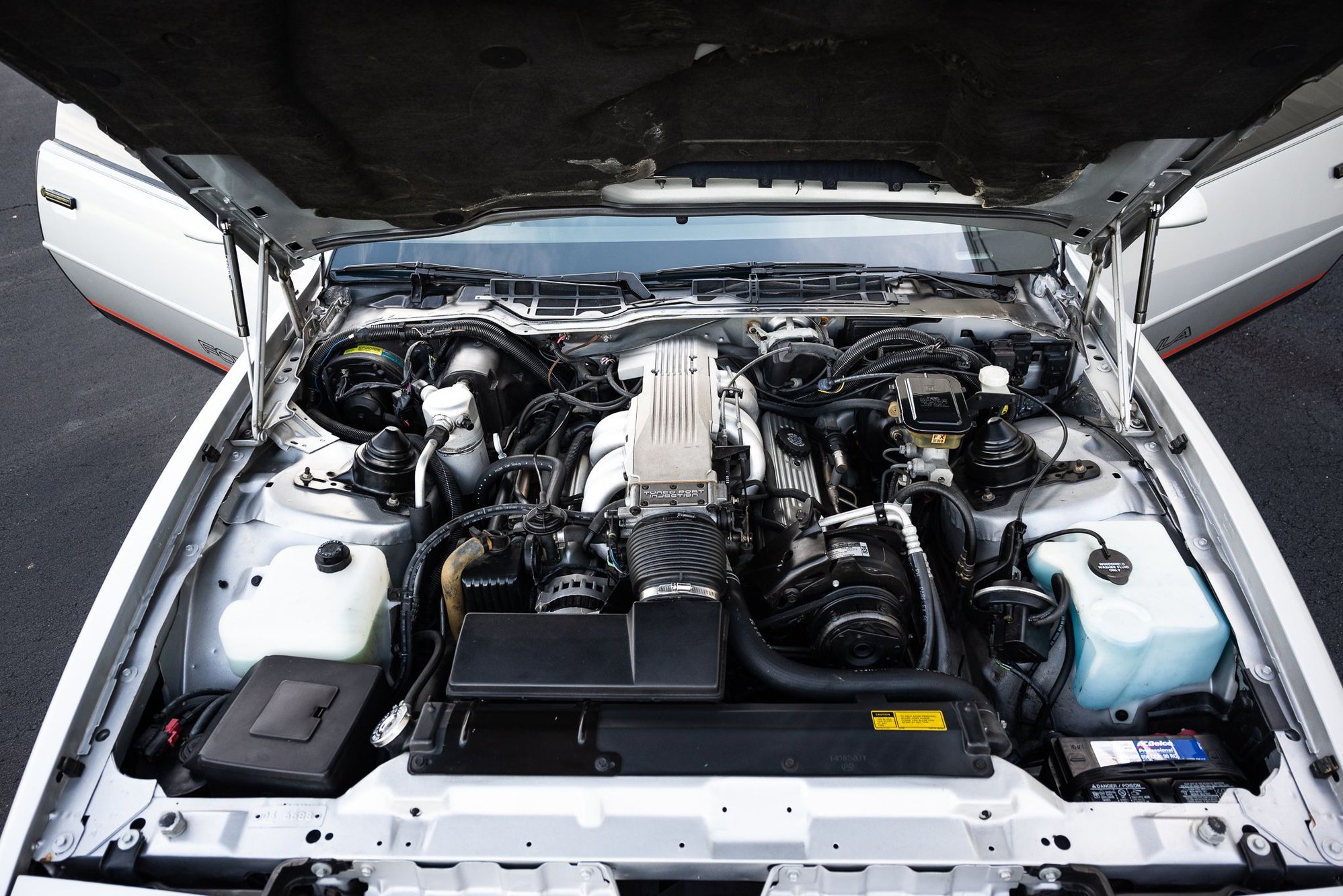

LB9 5.0L TPI engine
LB9 5.0L TPI engine

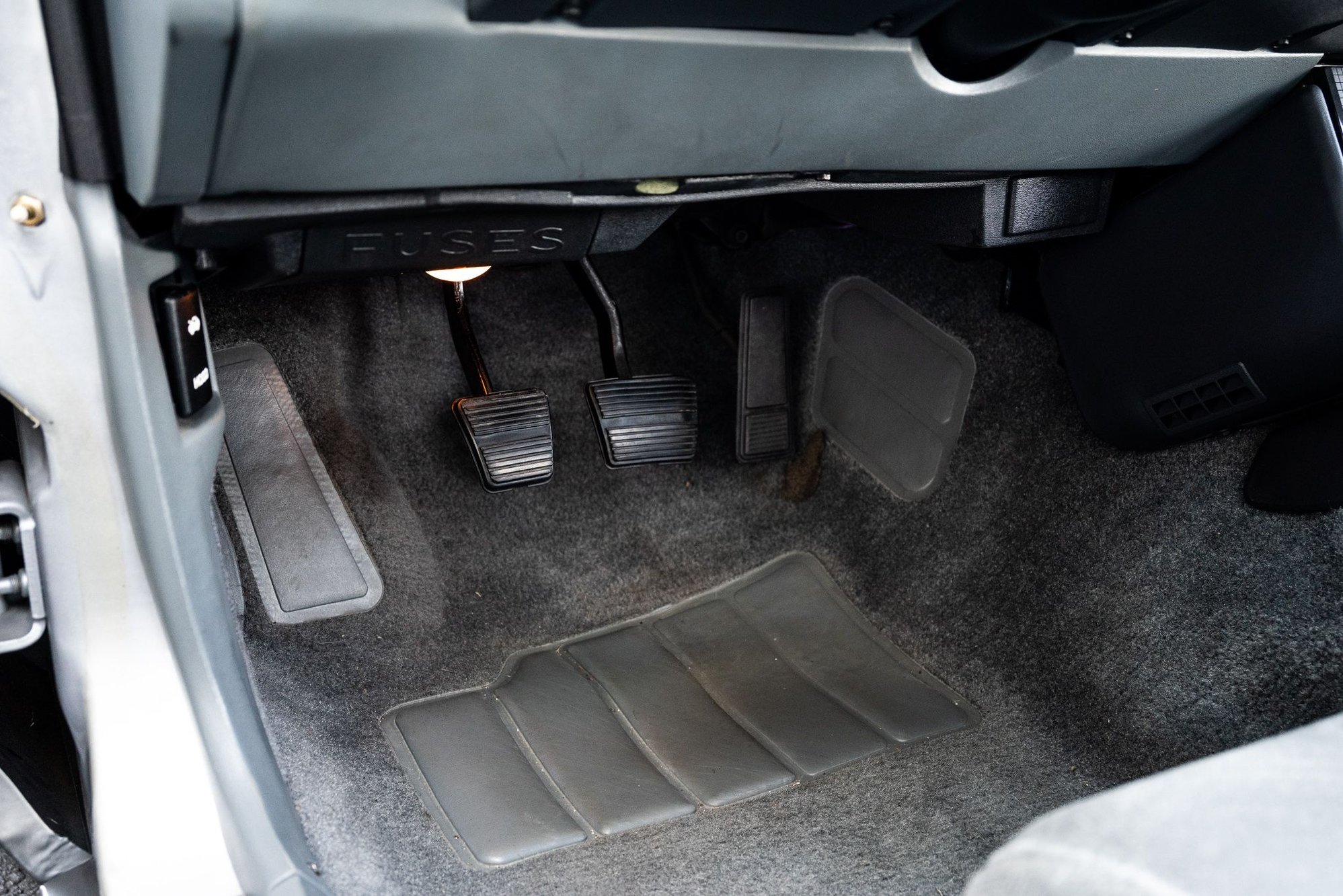

3 pedals
3 pedals

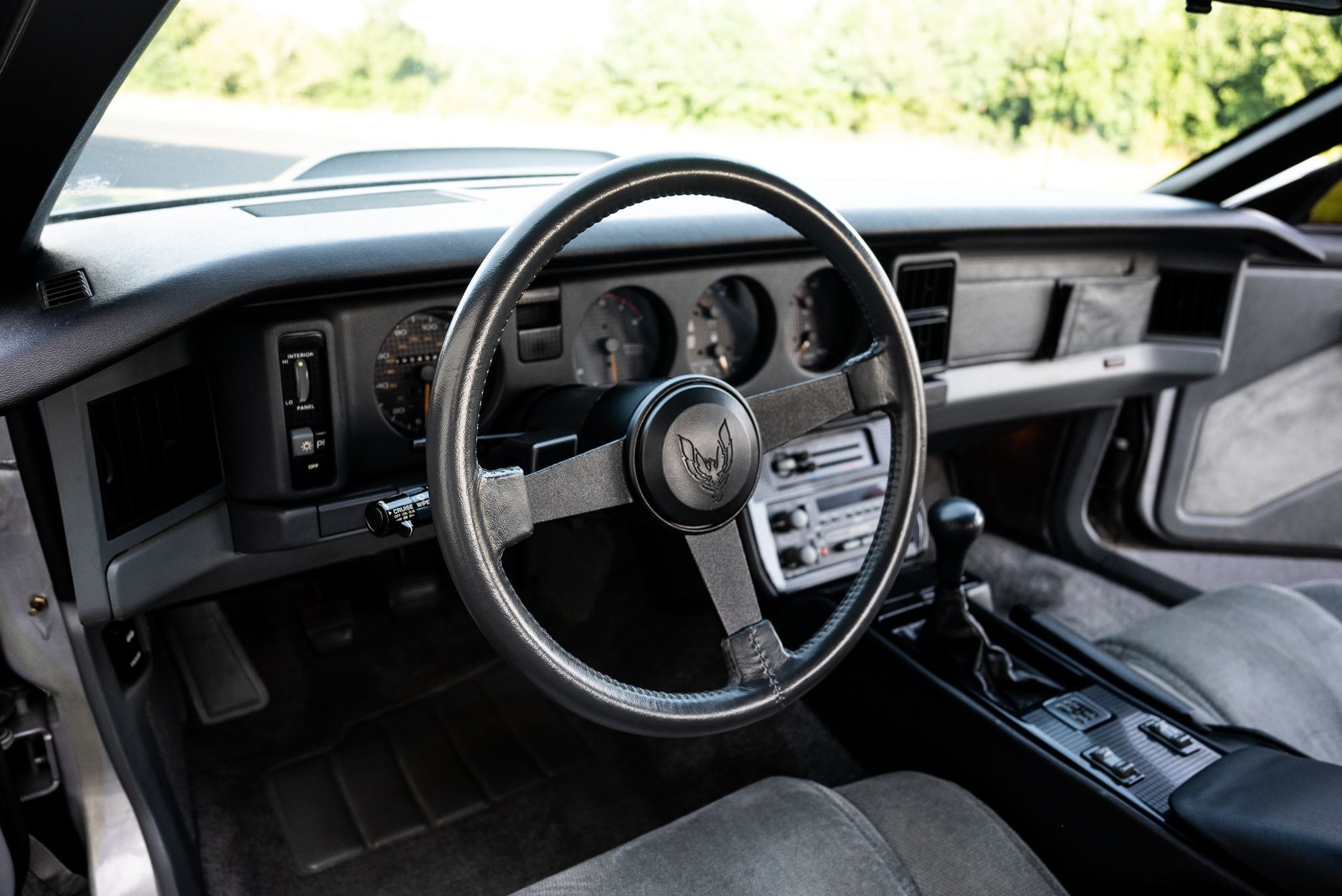

140 speedometer with 8k tachometer

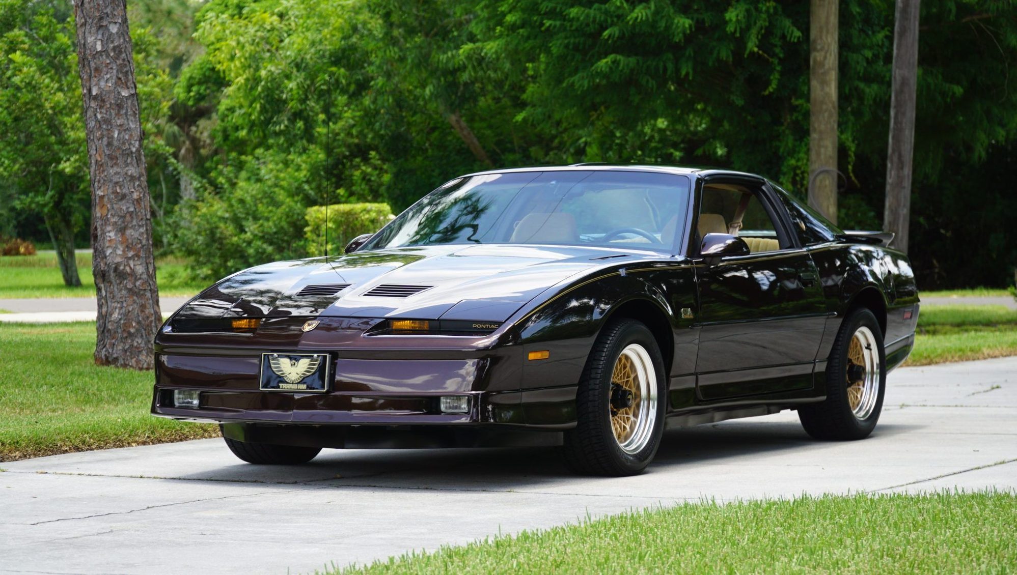

Another of what seems to be an oddball 1987 Firebird.
A 1987 Trans Am GTA with a LB9 5.0L TPI engine with MD8 4-speed automatic overdrive transmission, CC1 T-tops, 10-bolt rear axel, G80 limited slip differential, GU5 3.23 axel ratio, J42 aluminum drum brakes, and J50 front disc with rear drum brake system.
I've seen at least 3 1987 GTAs built this way. I don't think it mattered if it had CC1 T-tops or not. To get CC1 T-tops in the USA for 1987 on a GTA you had to order a credit option downgrade from the B2L/L98 5.7L TPI engine to the LB9 5.0L TPI engine for -$300.00 and Pontiac also took away the Borg Warner 9-bolt rear axel with G80 limited slip differential, GW6 3.27 axel ratio, and the J65 4-wheel disc brake system for a credit option downgrade of -$179.00. The other -$175.00 is a discount for the W63 Option Group #2 which is the highest option group you could order for a 1987 Firebird.
894-Mile 1987 Pontiac Firebird Trans Am GTA for sale on BaT Auctions - sold for $38,101 on August 11, 2025 (Lot #204,644) | Bring a Trailer
1987 Trans Am GTA that is also in a rare color like the Silver 1987 Formula above.
1987 Trans Am GTA that is also in a rare color Medium Russet Metallic/Dark Brown Metallic like the Silver 1987 Formula above.
