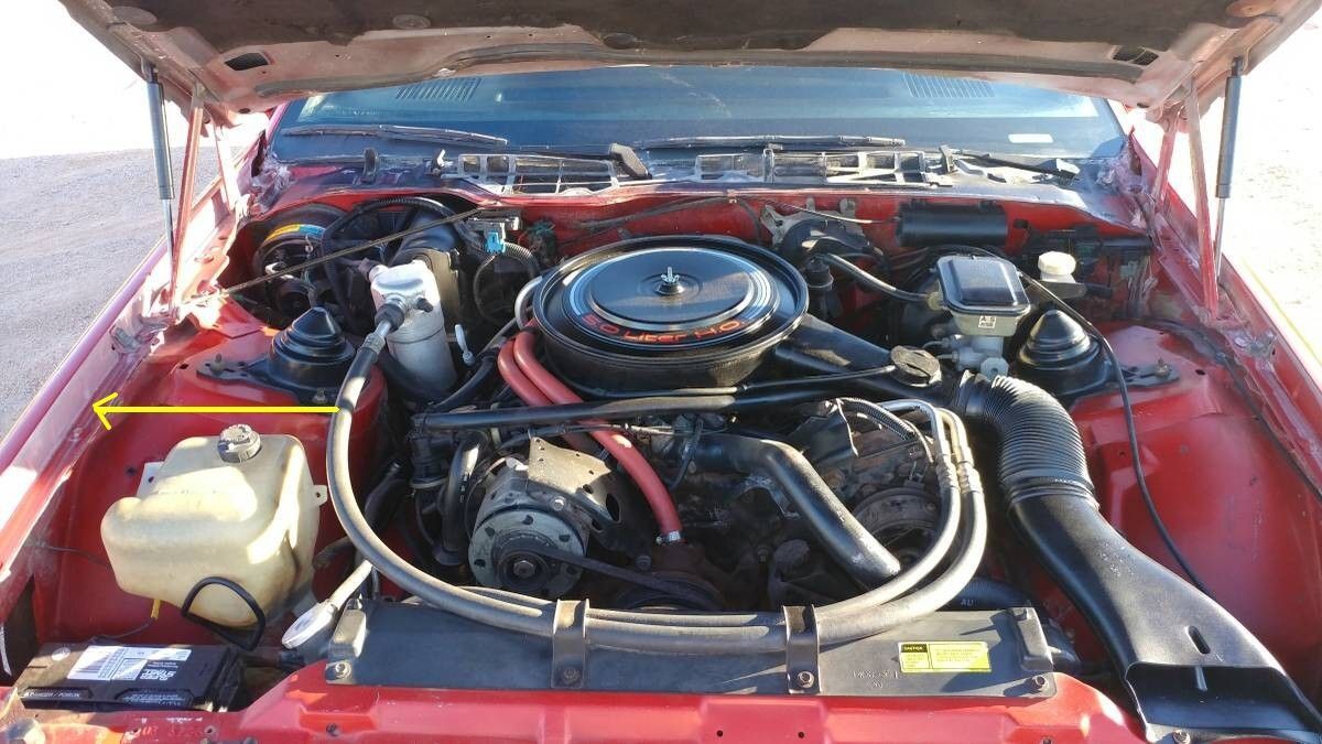

Do you guys think this is a real L69 86 Z28? The wrong lower air cleaner but it looks like it had the other air intake screwed in at one time and it appears to have an electric fan.
Thoughts?

Only The VIN Will Verify It.

If it is, it'd be the 1st one I've seen, ('86 Z28). Check the VIN. Either it's a unicorn or the seller is full of it.
I'm guessing it's an LG4 with a sticker.

Looks like the screw holes are on the other side of the core support.....get the vin.

That detail also is what peaked my interest. I asked the owner for the vin we will see what he sends over.

Is This White Paint.

Sure looks like it! He does state in the add the car was repainted. Could have done a color change.
Also, where is the washer fluid bottle?

It's not an L69.
He posted the VIN on Facebook when he posted the ad and I told him it looked like an LG4.
1G1FP87H6GL121956
He posted it up without hesitation so I think he was just misinformed about what he had.

You guys know most Camaros 83-later have the pilot holes, right?

Nope, didn't know that and with the better picture what appeared to be screw holes are actually the rivets holding on the core tag.

The more you know. When I dual snorkeled my 83 Camaro, the holes were there and lined up. The deeper I dig into more ambitious projects with thirdgens, the more pre-drilled pilot holes and other provisions show up. It's kinda nice when you don't have to guess where something should go.

86 z28 spid its an LG4
the guy sent me a pic of the SPID LABEL. It's for sure an LG4 car.
