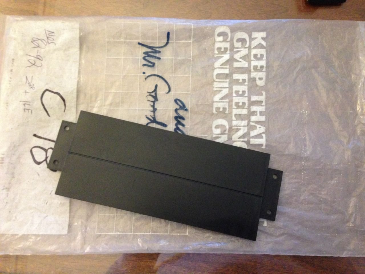

5500 RPM Redline tach and yes, with mine I got the antenna and the wire harness but delete plate was in place and the side trim panels behind the speaker covers were un-cut.
Wish mine was delete...I guess one day I will have to fix that too...ugh...pretty easy to remove that whole assembly and solder the wires...well use environmental splices I mean and crimp it with a butt splice
