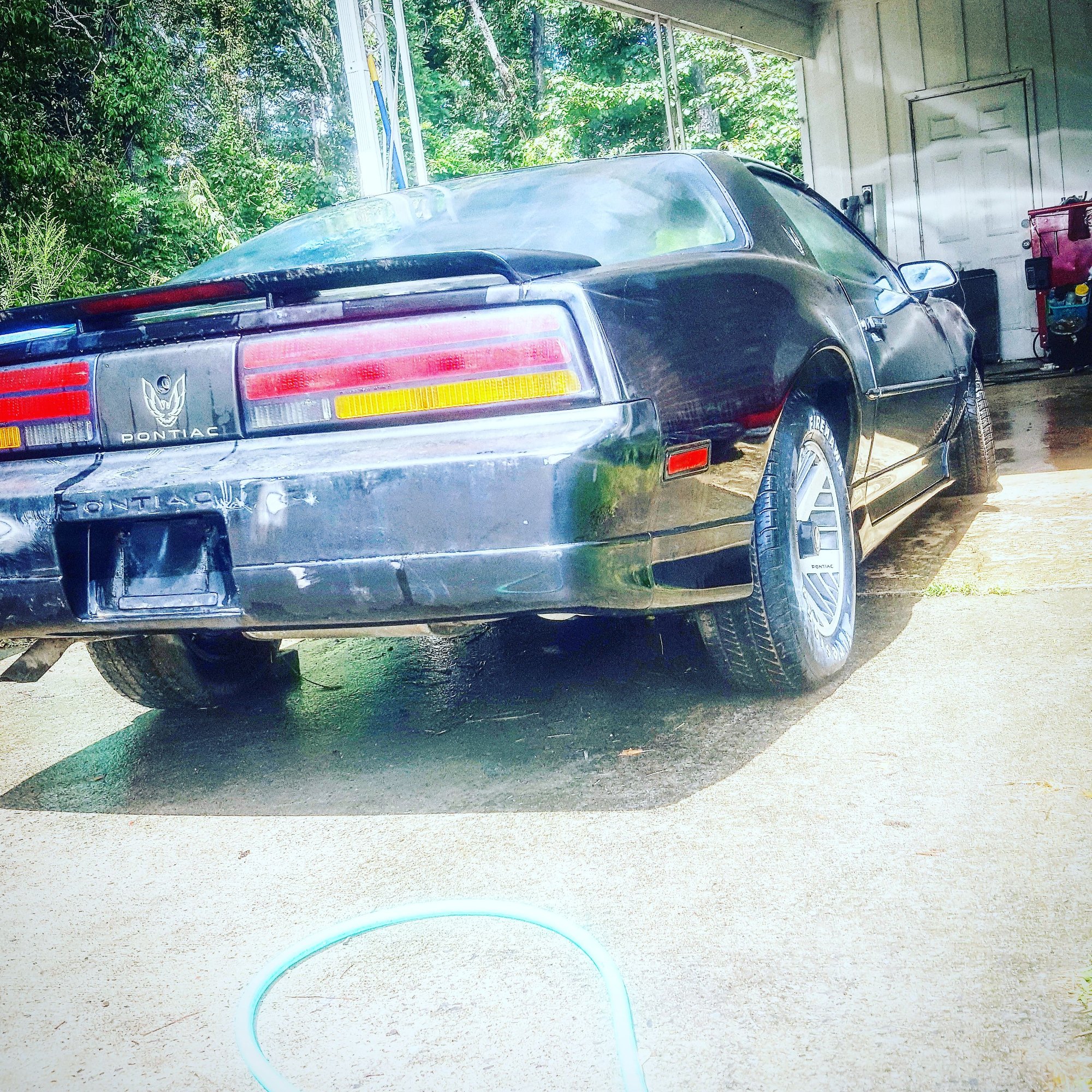

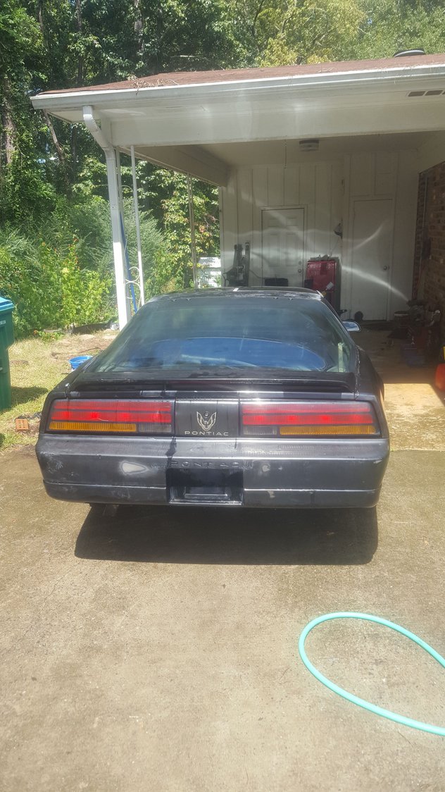

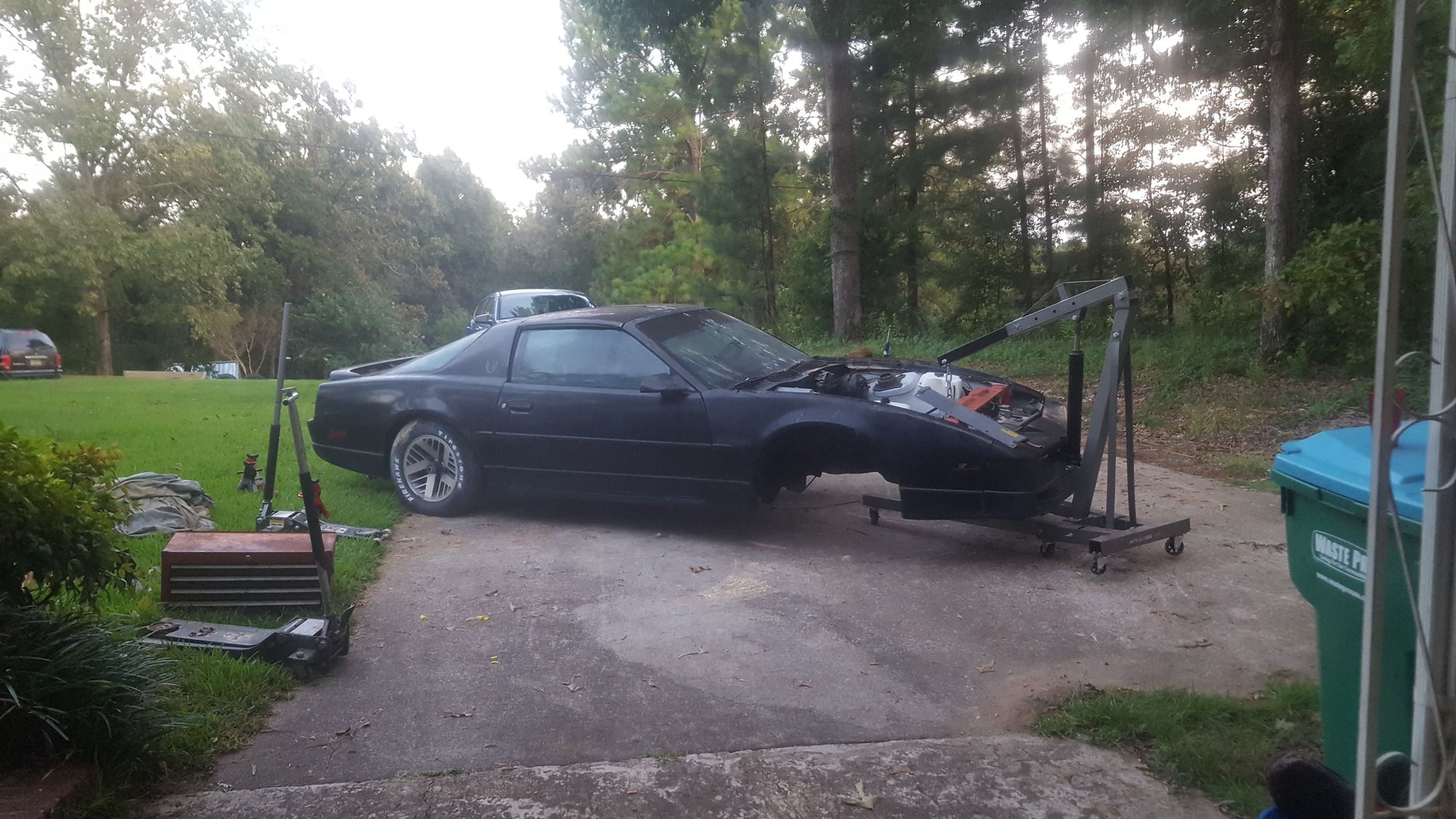

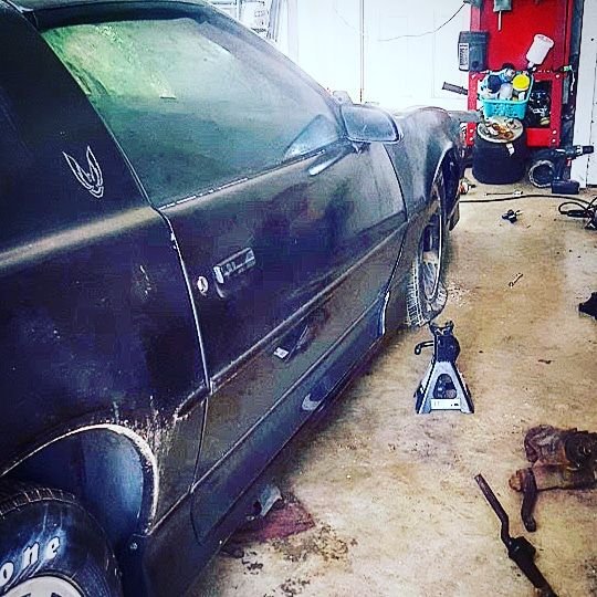

Pictures of the 89 Firebird XS
Please understand that the way the car looks is how i acquired it. It definitely looks rough but the potential is there.

"XS" is not from the factory AFAIK. Not sure what that is, myself. Most likely aftermarket though; I'd suspect it's some dealer-applied appearance package. Seems like it comes up on here once in awhile, seems like mostly from California people. I don't really remember seeing it when I lived out there though. I can't recall anyone ever asking about one that it had a V8; all 6-cyls. Don't know if that's just a coincidence or what. The Google, which knows all, might tell you all you want to know.
What "options" are you wondering about? Most are pretty visible... AC, power windows, power seats, whatever radio it has, etc. It pretty much is what it is. Nothing special. You can get the paint codes off of the tag on the radiator core support. It's not the sort of car that would have "value" as derived from particularly sought-after options or anything like that, if that's where you're going with this.

Dealer/Regional sticker/emblem package. Otherwise it's a basic Firebird. XS, SSA, same thing.

If the SPID sticker on the inside wall of the center console is gone, and the buildsheets aren't always located in the car or easy to find if they were, the only option left for an older ThirdGen is to purchase a copy of the vehicle invoice from GM Archives:
http://www.gmmediaarchive.com/?page=1
However, the invoice will not include every single option code that would have been on the SPID.
From the Pontiac Firebird 1967-2000 Photo History book by George W. Scala
"The front view of a 1989 Firebird with the Sport Appearance Package. Looking like a Trans Am or GTA, only the rims, hood, and rear spoiler gave it away. 15-inch wheels, the regular Firebird rear spoiler and the plain flat hood came on this bird. Firebirds in the Los Angeles area had "Firebird XS" emblems on the front fender. The San Francisco/Sacramento zone had "Firebird SSA" emblems. These dropped to just the "Firebird" emblem later in this year.
