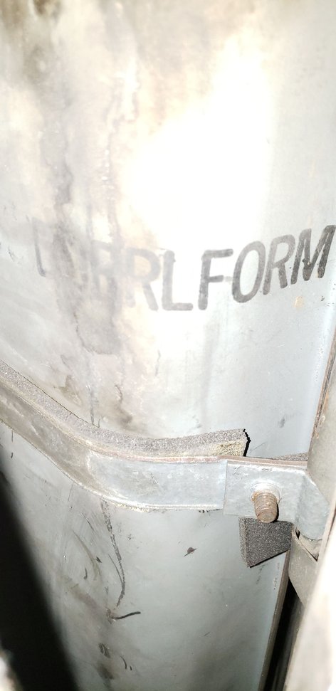

VATS relay jumped and VATS disable chip burned. First run (brake cleaner) since 2004.
Fuel tank seems a bit odd. I ran a bore scope down it and what I could see actually didn't seem too bad. There was a lot of light grey sludge on the walls of the filler neck that smelled like varnished fuel. Not sure exactly what that stuff is. Can't say I remember running across it before. There appears to be a hose section coupling the filler neck but I did not see this on the bore scope images. Filler neck seems suitably rigid so I'm not sure what to make of it. Maybe a replacement tank back in the 90's? Tell me what you see:
GD

I've seen people cut the necks off (had a parts car like that) to get the tanks out. There is also a tube inside the neck that most people don't know is there, did it get hooked back up? I highly doubt it. Real bummer when it's a baffled tank that gets hacked up.

Yeah now that you mention it, the tube inside the filler neck was there and looked fine. Now I'm really confused.
