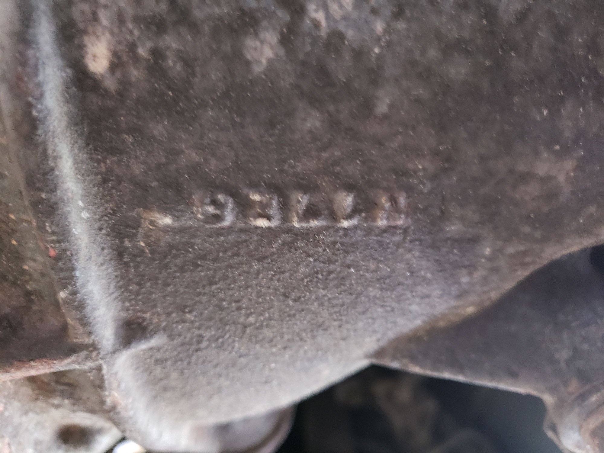

Wouldn’t there be a date code on the axle? That might help to figure things out.

Good idea , any idea where that date code might be stamped ?

Would a date code really help since the 9bolt was built in aussie land? I'd think they were probably built in batches and shipped over??
And these would be left over MY 1989 units, anyway.

Aren't the date codes and whatnot printed on the label stuck to the cover on 9 bolts anyway? Looks covered in undercoating in OP's pics. Mineral spirits or degreaser might make it legible, but it might also damage what's left of the label. Moot point since there's no guarantee the cover is original to the rear. The one time I located and decoded the stampings on a thirdgen rear, the codes didn't match the printed materials anyway. I'm not sure they're all that accurate.
I tried to compare the codes on the 9 bolt with my 1989 1LE car and other tags. Wasn't able to decode the numbers (or I gave up too soon). The diff looks like it has been in there since 1990 ... so either a replacement back in the earliest day, or a GM swap.
