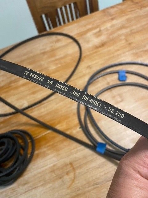

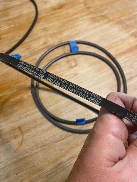

I have a 1984 Camaro Berlinetta with approximately 10,000 miles. everything is factory original except the battery. I was recently going to take it on a long drive, and decided I would replace the original belts... What a goose chase. I went to every name brand auto parts store and the chevy house with no luck. Every belt they had was a cogged belt, and this was even cross-referencing the actual GM part number on the original belt. So, to the internet - again, no luck. Outside of setting up a search on Ebay, is there a place where I can get these V-Belts (that is my name, and it probably isn't correct - so be kind)?
Here are the part numbers -
GM 469584
GM 469582
GM 14037745
GM 14079250
Many thanks,
Tommy
Blue tape has my numbering for ease of me remembering installation sequence

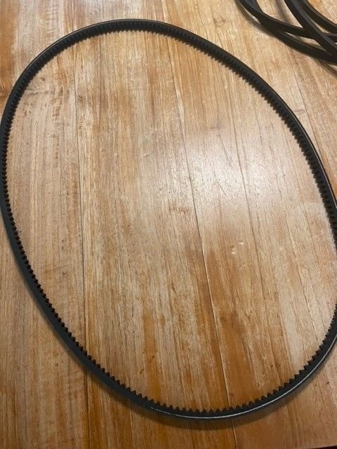

This is a cogged belt replacement I keep coming up with at the part stores / online

All The Major Belt Manufactures Have Switched To Notched V-Belts You Might Be Able To Find Some New Old Stock Unnotched Belts On Ebay

Being an old parts store counter guy, I asked our belt reps the same question way back when they started switching over to the ribbed styles because customers were asking the same thing of me. The Gates rep said they ran cooler thus creating longer life and were less prone to squealing. Uh, OK. That's a good sales pitch we can use from now on.
From the manufacturer's point of view, they probably used 1 or 2 less oz of rubber creating each belt which would equate into how many more belts they could get off the line for the same investment. Cha-Ching!
You take your pick, but I know which one I'm going with.

THIMK about what a belt goes through as it runs over a round pulley.
In addition to transmitting power by friction, and having to slide into the pulley and back out as the belt moves (more friction except this part is useless waste), the INSIDE of the belt has to COMPRESS, and/or the OUTSIDE has to STRETCH. No way around this.
Furthermore, the constant application of those forces to the belt, generates HEAT.
Rubber stands up fairly well to compression, but VERY POORLY to stretching. It responds EVEN MORE POORLY to heat.
Those 2 factors are what the inner "cog" belts are attempting to address. If the inside can compress easily as it goes around a pulley, ESPECIALLY if it doesn't give up much contact area, then it produces FAR LESS force trying to rip the OUTSIDE of the belt to shreds. Less stretching, less heat, less death.
"Original" only matters for car shows wherein the car is graded on EXACT "originality". I've been in lots of car shows over the years but NEVER one where "originality" was carried to that extreme. Not saying "there aren't any" or any such; only, unless your judges are THAT picky, it's a fool's errand. For everything else, such as driving the car around, advancements in technology are mostly a good thing.
