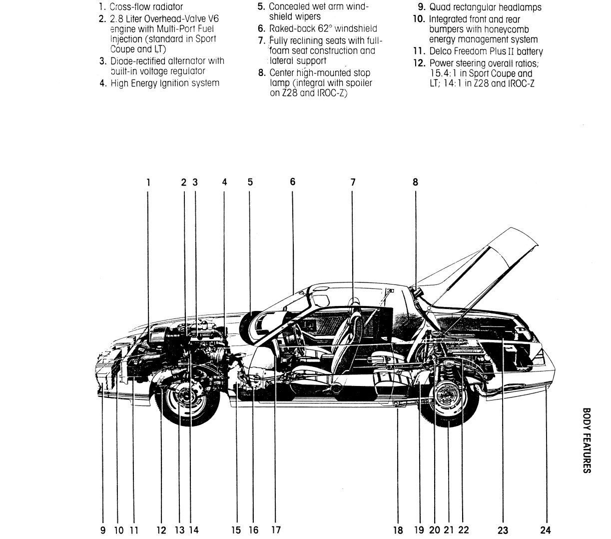

The 1987 Camaro brochure shows the following:
Thank you! That answers my question!
