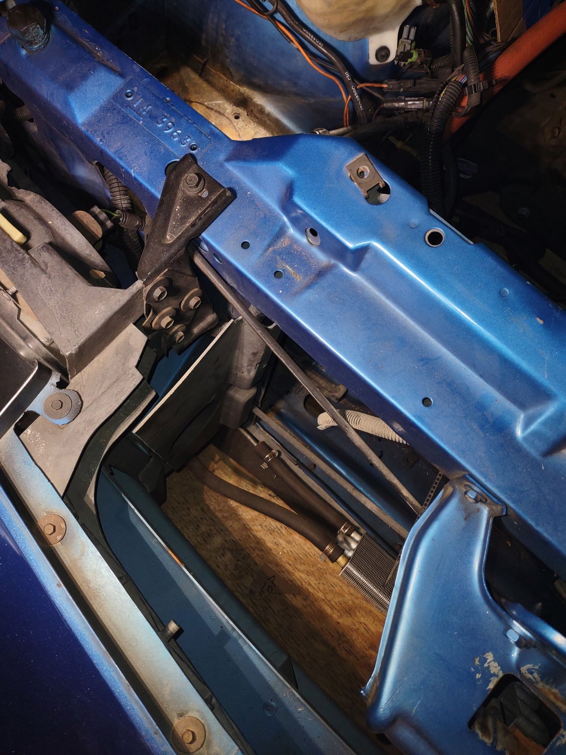

Build plate?
Old Oct 26, 2024 | 04:18 PM
Bobbycicc's Avatar
Joined: Mar 2024
Posts: 20
Build plate?
I have a 1986 iroc. Noticed what looks like a missing plate. Anyone know?

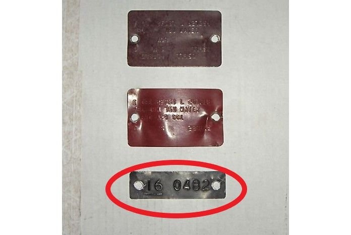

Found this picture online. I think I clicked it many years ago and posted it somewhere here on TGO for this same topic. The tag that began being used in 1986 is like the black one at the bottom of the three tags in the picture, but not all 86 and 87 cars got them, for unknown reasons. And it was placed on the top of the support in the area of the passenger side headlight, not in the original location over the fan, and that original location over the fan was left blank. But at some point, this new tag was relocated back to the original location over the fan. More searching showed that 1991 and 1992 got this tag back in the original location, but if it happened prior to 1991, then people will have to look at their own cars to see if they have the tag at all, and if the tag is near the passenger side headlight or back over the fan. The number sequence on the tag, XX XXXX, is a direct reference to the car's build sheet, matching numbers in boxes 1 and 10 on the top left corner of the sheet.
Edit: And here's a picture showing where GM initially put the new tag for 1986+, before moving it back in the later years. There are a gazillion images of 3rdgen engine bays online, but very few have the core support in the frame of the picture. I've circled the tag.

also the smaller tag with 6 numbers is supposably a code for the sequence number of the carpet and this was only used at the Van Nuys plant starting in 1986. this number also is on the build sheet..
