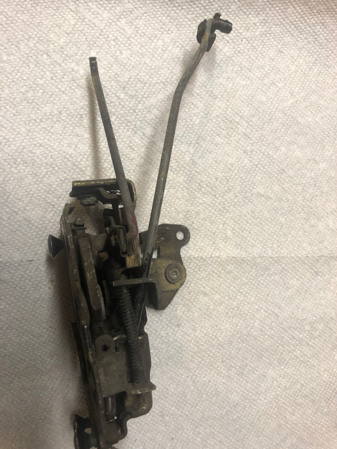

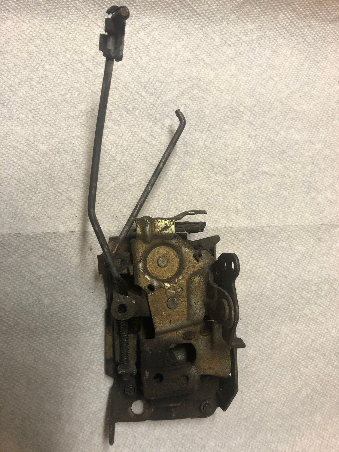

This?

yes, using the bottom pic, its the longer one on the left I believe. For the passenger door. What is kind of odd about that one in your pic is the bottom. Mine as an L bend on each side and slide into that black plastic clip on the top and it snaps over the rod. Hard to tell in your pic if the bottom of the rod is the same as the top.

My comments on this are that #7 from the parts diagram are the shorter rod in my lock picture.
Neither really look like the picture you posted below the diagram. This was from from a 1987 passenger door.

This is so weird. The rod on my driver door is very similar but the bottom is like the top, L bend that goes in to the same plastic type clip. Thats how it installed.

^^^That rod^^^ goes from the latch to the outside door handle.
The lock cylinder to latch rod is maybe 4" long, 90* bend on each end, zig-zag in the middle, plastic clip at the lock cylinder, metal clip at the latch assembly. Ie, it's the shorter one in the pics.
Gotta be a little careful about mixing parts relating to the door latches. The latches changed frequently, and GM used visually similar latches across different applications and in different years. If you're not careful, you can get weird results. That said, the parts catalog shows the same lock cylinder to latch rods for 86-91, so it should work...

TA8487 or Drew, YES that is the rod I need for my passenger door. I dont need the whole locking unit, just the rod. TA8487 I will buy the rod from you if OK, if you dont want to separate it from the locking mechanism I can by from Drew. Either way and I appreciate you both reaching out and helping a fellow 3 genner.
