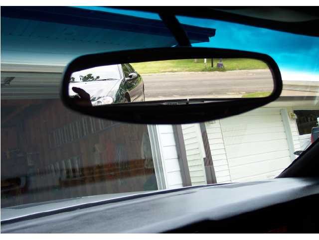

I installed a **** mirror (auto dimming, temp, compass) in my 85. The most difficult part, IIRC, was running the wires down the A pillar.
JamesC

Looks nice and I have added a mirror to the list for this summer when I do the drive train and paint.
Where did you locate the temperature sensor?

Behind the driver's side fog.
