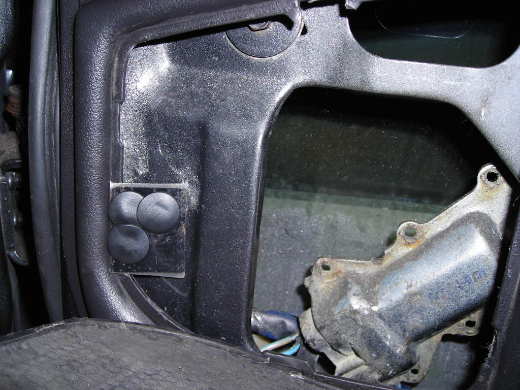

got the panel massaged in the front and the door shuts fine.
panel lined up nice all around with matching weatherstrip from panel to door.
all gaps looking good.
for some reason, the panel will unhook it self when i open the door. its clear around all areas. im thinking it may be my new GM roof seals. they are pretty thick, and about the only thing that could be forcing the panel off the door.
its held on pretty tight. it takes effort to bend the panel and get the factory hooks to slide in the holes i made on the 3rd gen door.

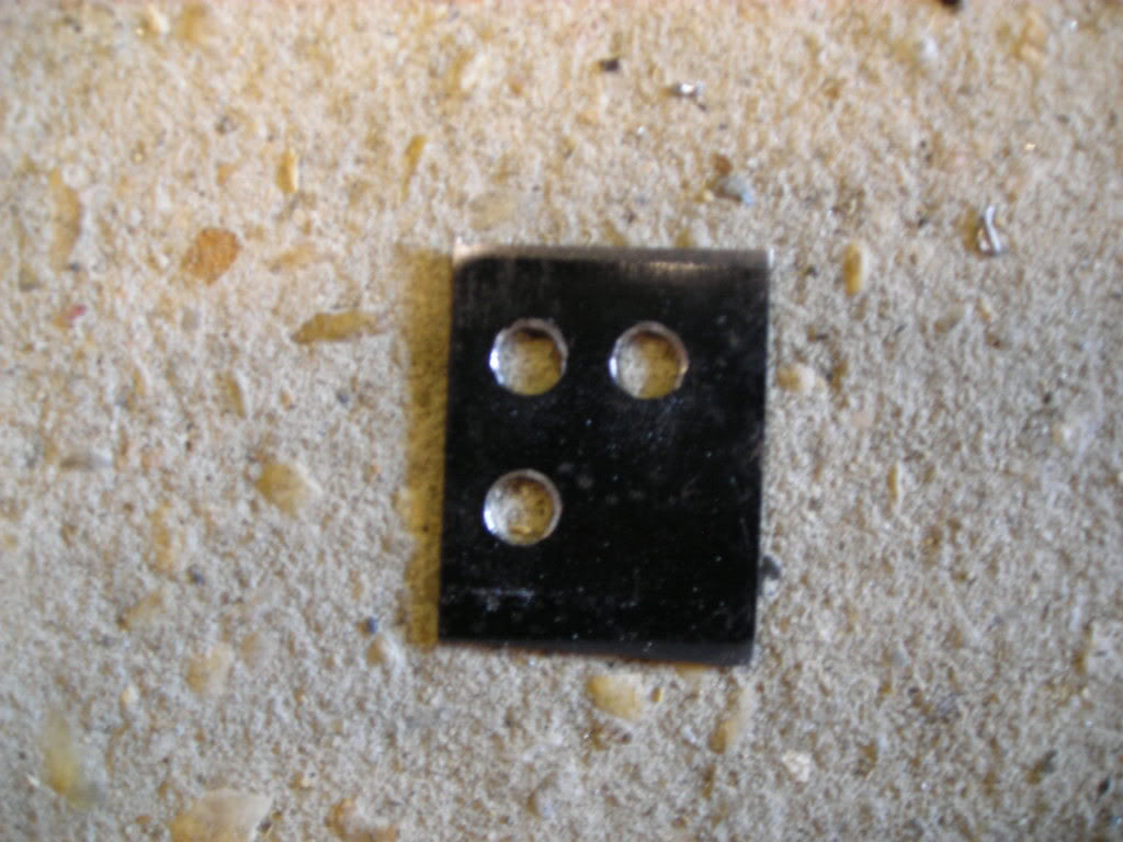

also made a small bracket to hold the bottom of the panel.
did one in the rear of the map pocket, using a push fastener so no ugly screw is showing. plan to do one to the frontmost side of the map pocket as well to secure the bottom of the panel to the door.
if i could keep it from popping off the door, id be set on finishing up the door handle and cutting down my weatherstrip at the ends to fit the newer panel.

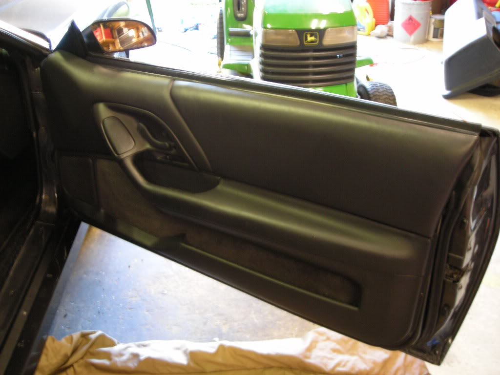

well, finally finished up the passenger side. its completely done, minus hitting it with some shine. i scrubbed it good with cleaner and its kinda dull looking right now. pics look funny to me.
no screws showing anywhere, panel is held completely tight.
i made a lil bracket and used some push fasteners to help hold the front corner.
it was flapping a bit, and i really didnt like that. cut one of the tabs off the speaker grill, and used the female portion of the connector for a base to hold the door panel tight.
also made some brackets and used push fasteners through the map pocket to hold it sturdy at the bottom of the door.
ive beat the door and cut as much of the panel as i could. it only sticks out from the door 1/16 visibly from the side and im sure the usual at the bottom(1") from what other people have posted, but you really cant tell unless you get down and dirty. the weatherstrip fits good everywhere. i think the flash is playing tricks on the gap in the pic. its got a but in the front and rear, with only 1/8" towards the middle. its not as bad as it looks in the pics.
im pretty happy with the way it turned out. i think.

00-02 camaro correct panels. ebony leather.

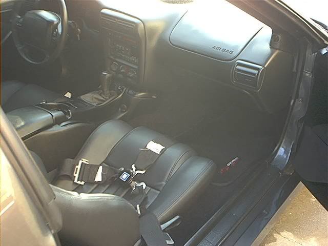

Originally Posted by kylemm1002
can you take so more pics of the whole interior? I would love to see the whole car
thats all ive got at the moment. thats an old interior pic from a couple years ago. i dont have any new pics with the finished panels yet.

finally got out and took some decent pics.
