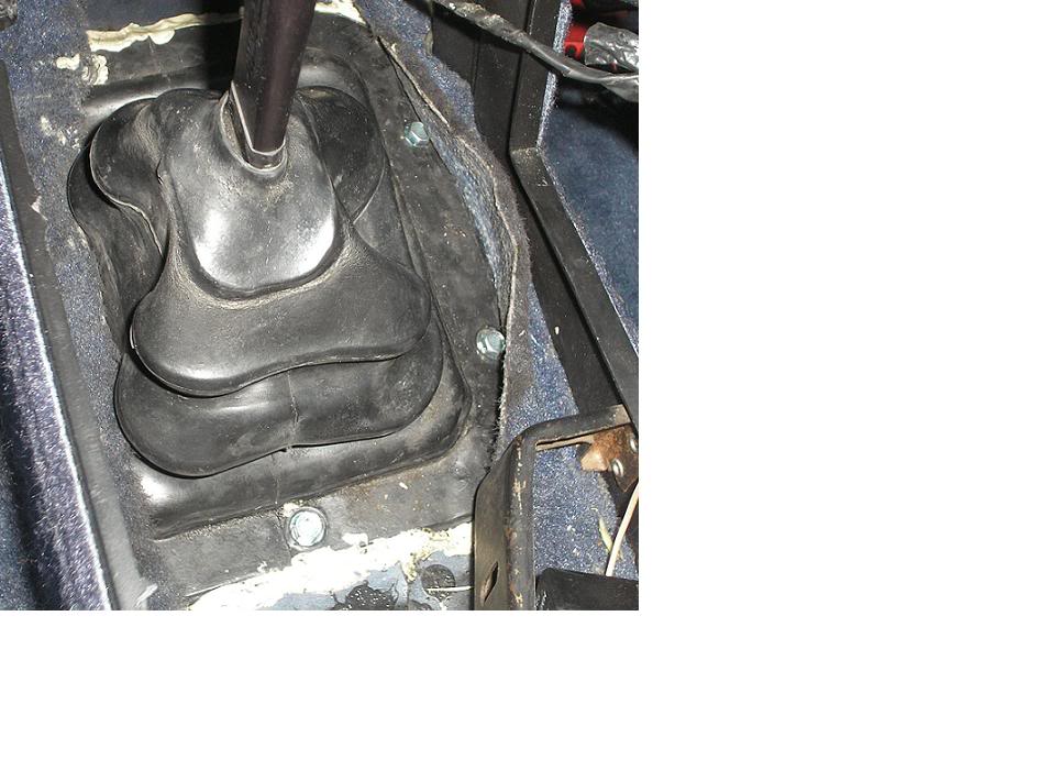

Old Sep 28, 2008 | 08:50 PM
Kevin84Z28's Avatar
Joined: Sep 2004
Posts: 1,064
From: Sonoma CO. CA.
Car: 1984 Camaro Z28
Engine: L69 305 H.O.
Re: E Brake gets really really hot.
I took the console out and took a good look at what was going on. Took it for a ride and could feel the air moving up from under the shift boot. I looked closer and noticed that I was missing 5 of the 7 bolts necessary to hold it in place. Problem solved.
