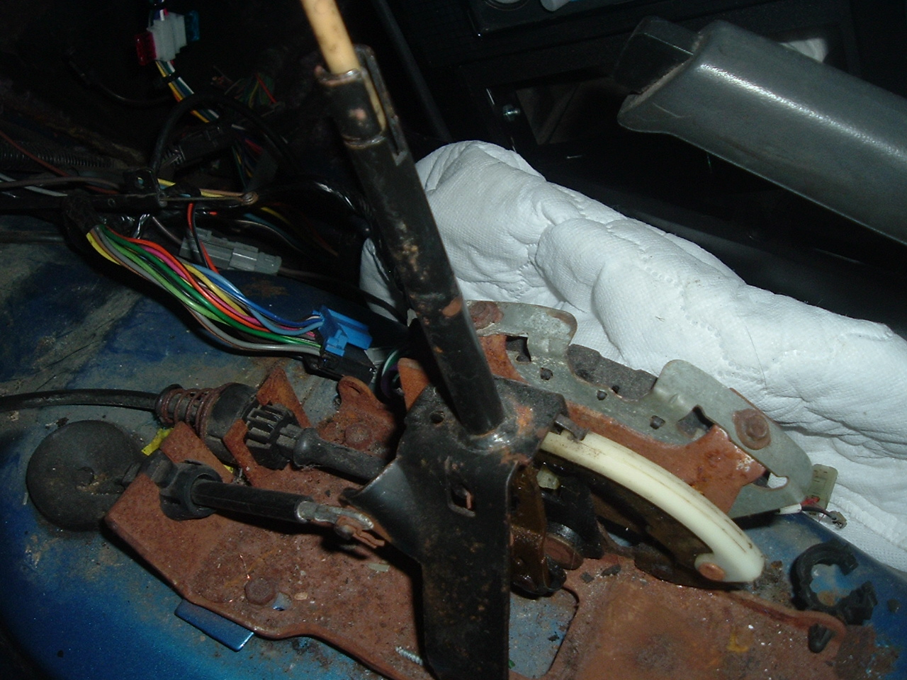

Actually you need it to tell the car when it is in park, reverse, neutral, or drive.....if you try to disable it you could run into serious safety issues.
Just put it back where it goes on the shifter, I attached a picture.

all it does is prevent the steering wheel from locking when the car is in drive.
it is disabled on my car because i installed an aftermarket shifter.
just make sure that if it is disabled, that it is all the way in, so that the steering wheel can lock and you can remove the key.

It prevents you from pushing the shifter button so you can't take the car out of park without the key.

The park lock cable is suppose to run under the carpet and come up around the area of the center console with a loop towards the firewall. If those wires are indeed the wires I think they are you would be best to wire them into a neutral saftey switch so the car can only be started in neutral and park and not in gear, or to a clutch saftey switch so the car can't be started unless the clutch is depressed. However if you simply connect them togather it will work, you will just lose the saftey feature of not being able to start the car if it's in gear, that is if they are indeed the wires I think they are. If you could post a picture of them I could confirm it for you.

the park lock cable attaches to the base of the shifter and is actuated when you push the shifter button.
the purple and orange wires attach to a wiring harness that also goes to the shifter.
id post a pic, but i just replaced my shifter.
as stated earlier, if you wire them together, you will be able to engage the starter with the car in drive or reverse.
