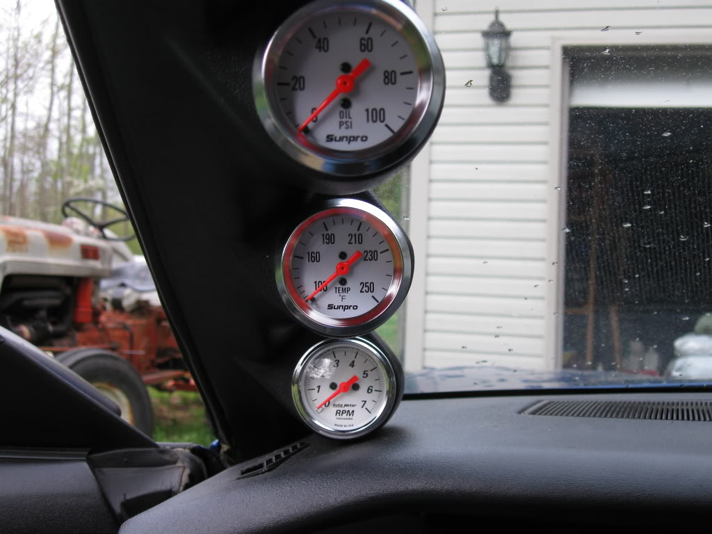

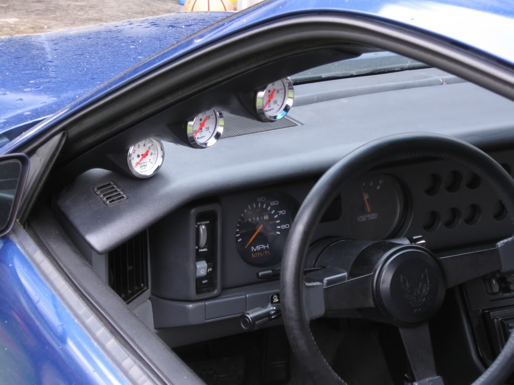

Over the weekend I installed a triple pillar pod from Autometer. I haven't ever seen anyone else use one of these but maybe I just haven't been paying attention.
It mounted over the factory A pillar very well with no noticeable gaps.
Anyway here are some pics.

very nice, not bad at all... did you notice a fitment issue with the bottom gauge hitting the dashpad, it does on mine...

Yeah mine hits the dash pad too. Really it just helps to keep the pod nice and tight though.

The pad is held in by a row of screws along the front and 4 screws in the defroster vent. It's really not that bad. Just be careful as you pull it out. The hard part for me was tapping into power wires for the gauges. I also removed my gauge cluster so that I could get at the power wires and the tach feed. It's pretty cramped.

Yeah and don't make the mistake of installing the dash pad and pod before you put your gauge cluster back in. I didn't think I'd ever ever manage to get it back in with the pad already in.

As for the other info... My lowest pod is pretty hard into the dash. Makes a nice little divit after a few years. But, it keeps it tight like OP stated.
Also...forget about pulling the dash pad with the pod in there. Even if it were possible, why risk cracking the pod or the a-pillar. Its one little screw, ont the t-top cars anyway, to pull the pod out of the way.
Looks good OP! Its WAY nicer than random gauges screwed all over the place or under the dash... In my opinion anyway.
