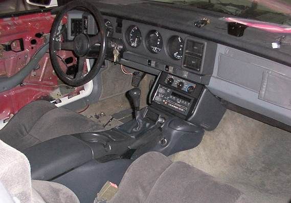

Corsica kind of fits.
This is the only picture....

Deadbird that looks pretty good. Can you get a closer pic?

I would take a better picture for you but, the control isn't currently mounted. In that picture, the controls are just kind of sitting in there. I don't remember what I was taking a picture of but, it wasn't for the controls, sorry.
The controls for both are the same as far as mounting. The faceplates being the only difference. But, that doesn't affect mounting or trim.
As far as electric controls, I would imagine you would need the servos from said car the controls came from. IIRC the Corsica had an electronic selector for the temp which I replaced with a mechanical one from a 4thgen. I wasn't too interested in extra wiring just for an electric hot/cold servo.
The one thing the Corsica controls had, like 4thgen, it's a bi-level selection (foot and defrost). To make the work you ne a bi-directional vacuum servo. I never got that far to seeing if a Corsica or 4thgen servo would work. Even if not hooked up, the 3rdgen vent would just default to defrost anyways.
I was never able to find another radio/hvac trimplate. The trim covers over the control face a little and needs to be opened slightly. I didn't want to ruin my only one so I held off on going much further. I may eventually try to make a new faceplate but, for now, I've got a mountain of other things to concentrate on.
I know that wasn't very useful but, that's just about all the info I have.
