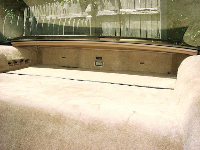

What do I use to keep carpet on panels?
OK, so I have the whole rear hatch area re-done with cleaned-up panels and brand new carpet on most of the pieces (I dare anyone to tell me which are new and which is original!).
Anyway, the carpet is coming off the panels. I originally used 3M Heavy Duty spray adhesive, but that came up right away. Then I used Carpet tape, which is really sticky. This worked for about 2 days, and now it's starting to come away from the carpet.
What should I use to keep that carpet in place?
Thanks!
Chris
Attached Thumbnails What do I use to keep carpet on panels?-newinterior01a.jpg

Wow that looks really nice. Have you tried actual upholstery spray adhesive? I dont think the 3M Heavy Duty stuff is strong enough for something like the weight of carpet.

Thank you. The 3M stuff was supposd to be for Upholstery. I think I'm giving up on the spray stuff. When I pulled the original carpet off, the adhesive was a thin line. I'm thinking something like contact cement that hardens, but I'm not sure. Anything sticky comes up when it's too hot outside.
