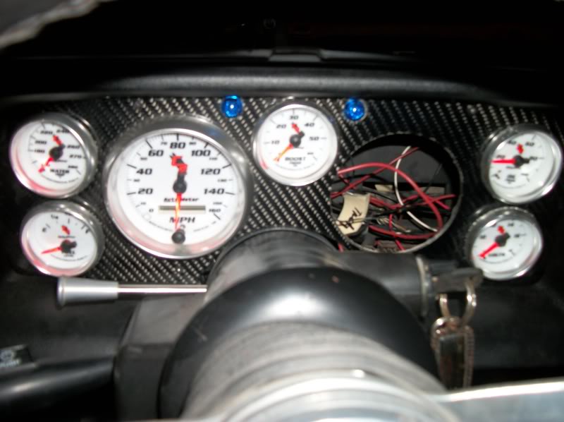

vrey nice they look like mine mines carbon fiber tho Name:  100_0165.jpg

sorry forgot to do the tach went i took the pick Name:  100_0175.jpg
