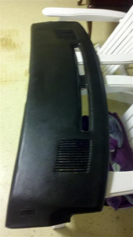

here it is... not perfect, but considering where I came from, what I did, and the fact that I'd nver done this before, it's pretty good
the thing I learned the most was how to spread the glue with a spreader instead of out of the gun.. mix up small amounts at a time, and work it in and work it smooth, then sand it down with60 grit sandpaper and a small electric hand sander

here's my attempt at fixing the damage... it looks better in person than in the pics
except for the corner, it looks like a brand new dash pad... now if it will just stay that way

put it in today... it's not mint, but it's by far the best one I've ever had, so i'm happy
