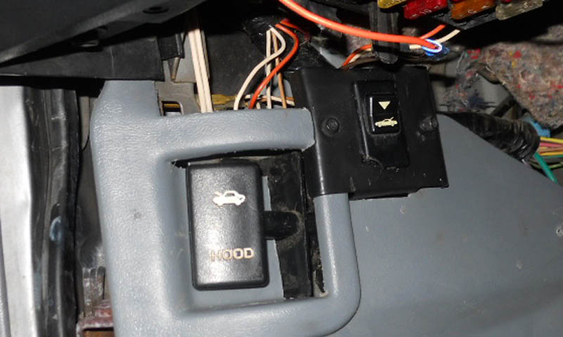

These things can be wired directly (assuming your solonoid hasn't gone bad) but I don't like them on the center console that way, there's too big a chance you will hit it while driving. I installed mine to the area right next to the hood release. It's just a 12V power source to the switch, and then the switch continues that right back to the hatch. really simple
