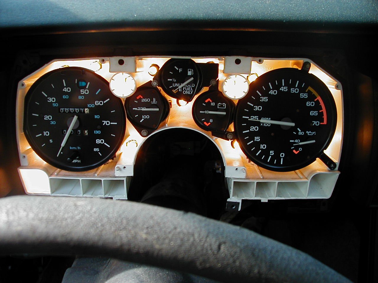

no, you have to pull the cluster (the white plastic holding the gauges in) i know on 90-92 theres 4 bolts, 2 on top and 2 on bottom, that hold the cluster in.
heres a pic of an 84 (i think) gauge cluster. you can see where the bolt holes on the top are.
edit: i guess it helps if i attach the pic....
Attached Thumbnails solution to a brighter interior and interior gauges?-clustergaugev680mph.jpg
ok iv got down to where like what you have in the picture and iv got every gauge out but cant figure out how to take out the speedo. i remember seeing to black nuts on the bottom is that what i need to remove?

Re: solution to a brighter interior and interior gauges?
if you look at the pic i posted earlier, you can see where the two bolts mount the cluster at the top. in the big squares just above the big circular light holes. since you have a cable driven speedo, you might have to disconnect the cable. i dont know how much slack they have or how far you can pull the cluster out with it attached.
