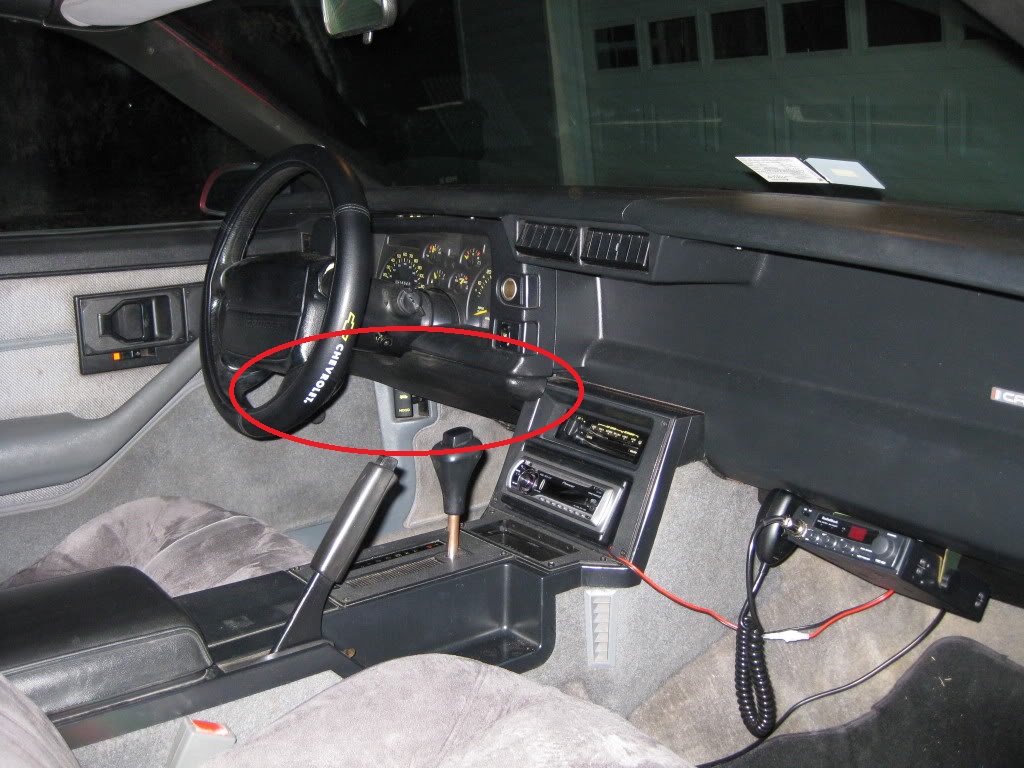

I have a pair of Camaros, and Im taking a few things off one car to make the other complete. I want to put the knee pad under the steering wheel from one car to another, but I dont want to damage it when I remove it. Does anyone have any suggestions or do I just pull it off?

circled in pic

There are 5 T-27 Torx bolts holding it on. At least thats what they started out with. Two on the front ends sometimes under caps that pry out, and three across the back. When they are all free you have to pinch the three clips on the piece behind it to separate the two. You will see how to do this as you slowly lower the front piece. Reverse for reinstall. Enjoy!

Thanks..Im sure I would have screwed that up if I didnt know first!
