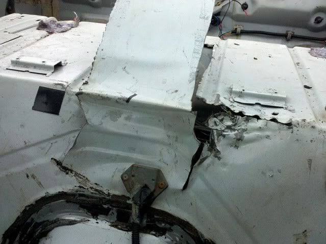

if the job starts to look like this, you are doing it WRONG
