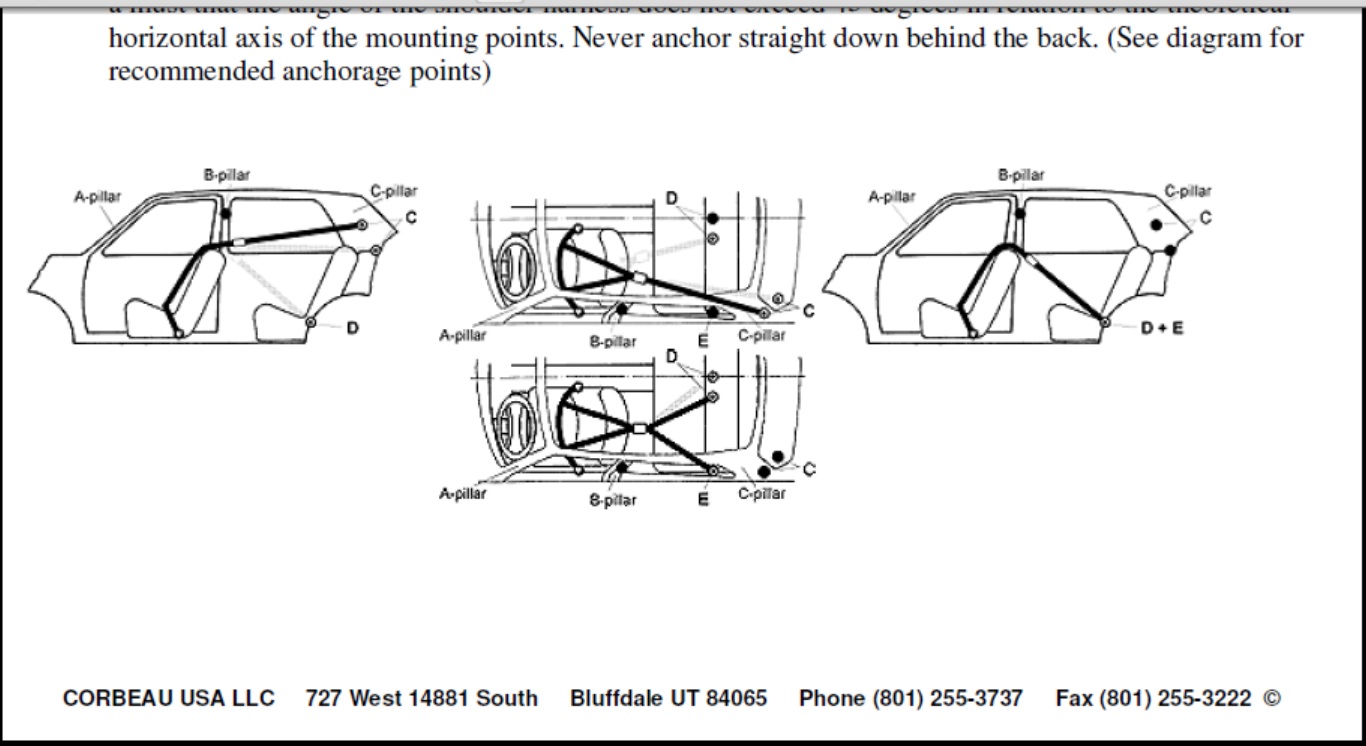

You keep harping on that 3-pt thing. We get it, OK? 4,5 or 6....The shoulder straps still need to be mounted the same way.
But REGARDLESS of how many points it has, the shoulder straps have to be mounted a certain way, which yours are not mounted LEGALLY. No sanctioning body would allow your belts. I can say that with certainty, since they are obviously mounted way too low to satisfy any rules.
Show us! Until we SEE a pic, we'll think it is not even installed, just hanging over a seat. Without pics, you are only reinforcing the thought that is probably IS just hanging there, not even bolted down at all. A pic will show where the back of your 3-pt goes to. If it goes straight down to the floor? Bad mounting. If it goes to the rear deck & the strap is only clipped in (see? i do know something about how harnesses are mounted) only with the rear seat flipped down? Well, it depends on the height difference between your seat shoulders & the mount.
I've said this part before, but I'll say it again.....
My entire point regarding your belts, was that it appears to not be SAFELY mounted. It appears to not satisfy ANY racing class rules. For a PURE show car, that actually sees no track time & is pure glitter? Sure. That is fine. I still can't agree with stuff mounted bad in a show car, for the same reason I didn't like seeing your pic. People who know nothing about harnesses might look at such bad mountings & do that in their real race car, then get mad when their spine get crushed or the car rolls over & they get crushed.
Factory 3-pt seat belt are designed to allow a person's body to lean to one side in the event of a roll over, preventing their heads from getting crushed when the roof collapses. Even if yours are mounted correctly, without a roll bar that still makes them unsafe.
Lots of people use a simple harness bar for autocross to hold them in firmly. For the most part that is OK, since they are running solo in a big flat empty parking lot with nothing to catch the car & flip it over. There is always the slight chance that a tire could blow & the rim dig into the asphalt & flip the car, but that is the car owners decision to risk.
Corbeau even makes such a bar for Mustangs.....
http://www.corbeau.com/products/harn...g_harness_bar/. Just because such a product exists, that doesn't make it the best choice.

OK....I thought I was done with this thread, but just got this from Coebeau, so there goes his idea of him mounting Corbeau straps safely.
Quoted from Corbeau & is on the pic I attached..... "Never anchor straight down behind the back. (See diagram for recommended anchorage points)", which is exactly what he has done.
Now he'll argue with Corbeau that straight down is perfectly safe!

finally i have like the 3 demo there happy i never had it straight down i told u that before went u buy a harness that sheet is included there duh!!

For the billionth time! Shoulder harness straps are shoulder harness straps. Regardless of how many points, they ALL have to be mounted the SAME WAY!
I just showed you that even your precious Corbeau tells you NOT to mount them straight down. And all you wanna cry about is your precious 3-pt system.
And yes.....You have said that you have it mounted straight down to the seats. Now your gonna cry that you don't, yet you do. You've already said so & now your changing your story.
Again....1 simple pic would show the world your not quite the moron we all think you are. Still a moron, just not quite as bad of one.
