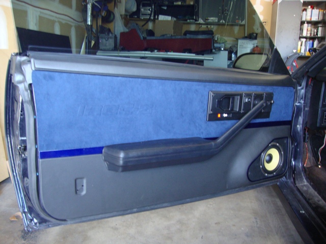

door panels almost done

I love the diy projects that people do. Those panels look very sharp. Just one question, What was used for the divider strip between the top section and the bottom?
I really like the subtle iroc z in the upper section. I would give that a two thumbs up.

the divider is made of 1/8" mdf and on the rear panels its heat formable abs to contour the shape

Wow that looks clean. Superb job! How did you mount the speaker with the window motor there or did you re locate it? I don't see it in the picture.

I bought a kit from electric life. it was manual window crank, new one bolted in very easy and motor is mounted higher up in the door. The speaker was spaced out 1.5" to accomidate the depth of focal krx3 woofer

I first got a piece of .125" steel and welded it to the door so i have a sloid mounting point for the krx 6.5 woofer it is very large and heavy. I used dynasorb and dynamate extreme on on inner and outer skin of door. Used origional door panel and a template for size and cutouts for handle and door clips etc. Test fitted and traced out door armrest and upper trim placement. used another piece of .125" mdf and glued over top of traced piece to cover door clips. Added ring and cut out woofer hole and filled for smooth transition.

covered in alcantara suede and black leather with painted rings and accent and grills. and the back of the panel was painted with truck bed coating. the iroc was raised with vinyl and the indention on rear of panel is for the camaro emblem that is on the nose of the camaro when i buy two more the will fit flushed in the door panel.
