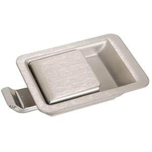

Anybody have any ideas for a latch/catch that would look at home back there? I'd just use a cylinder lock like whats on a toolbox, but I'd rather not have another key on my keyring. I'm thinking I will use simple aluminum angle mount brackets for the hard side. A couple of stealthy black flat head cap screws will allow for easy installation and removal.

What about a simple slide latch.....we have one on our outdoor storage cabinet, as well as on my daughter's car for the 'door lock'. Basically a channel on one surface that a flat piece of plastic with a nub for a handle on the other latched surface slides into to secure the door. Don't know where you'd score one.

I think this one will work good. $14.74 on Amazon. Although after thinking about it, with the sub being in such close proximity to the panel, I might have problems with the vibration making it rattle. maybe a "lift and turn" type compression latch would work better.
I'm also thinking a solid perimeter around the hatch would work a little better too. As shown in the pic.
