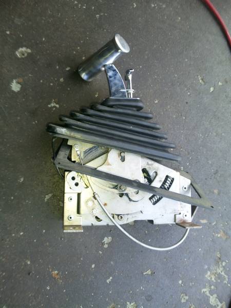

Hey guys,
Ive been looking for a B&M shifter for my Iroc and I think I have finally found one, but the guy isnt 100% sure what car it came out of. I have some pics of it, so if someone could either confirm or deny its the right one I would appreciate it
Attached Thumbnails Right shifter?-dvc-1.jpg   Right shifter?-dvc-2.jpg   Right shifter?-dvc-3.jpg

Its the right one.

700r4 by the way..
Ok thanks jake.
Ive been looking at other used ones, and some seem to have a little mount on the bottom of them to lift them up a bit further? So i was just wondering?

That is the right one for a 700R4. Your right thought the mounts are missing. There should be two of them. I would also check to make sure the switches are there. There should be three of those. Two attached to the shifter and one that looks like a black box with a bunch of spade terminals sticking out of it.

those are horrible... hated mine. sold the complete kit with a relay wired in... you will have fun installing a relay and cutting your neutral safety!!!
without the step up blocks. you will need to cut your factory shifter to bolt to... I preferred this.. and not the blocks.. and you need the 2 mini trigger switches

Ive been looking at an other used one with the cable, mounts and shifter, it just does not have the shift plate/ indicator. So I figure between the 2, I could have a complete shifter for less then a new one
more pics..
Attached Thumbnails Right shifter?-getattachment.aspx.jpeg   Right shifter?-img_0207.jpg
