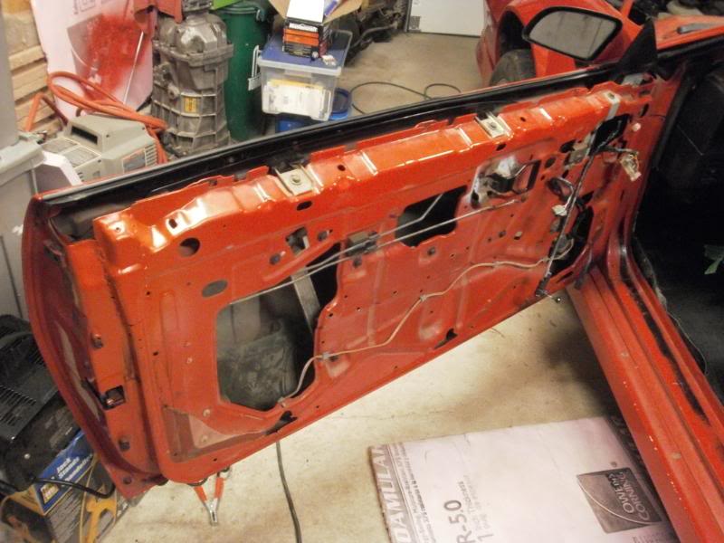

SO now I need help. I have a 92 RS I just bought for the gf... in descent shape..
Well the passenger side door has had the rivets drilled out to remove the window motor. I need help with 2 things and i'll tell why i need the help.
1. What size bolts, washers, and nuts will i need to reinstall the window motor bracket back onto the door. (just dont know what size)
2. Where are the holes i need to use to bolt this thing back together, and if i can get a photo that'd help the most.
Why is a photo needed... well like i said above the owner before last was a MORON and this car was a.... sad to say... Drug runner (even says on the carfax why the car has a prior salvage title, it was impounded by the MO Highway Patrol for use in narcotics trafficking) well if anyone has ever bought a car like this knows, they hack stuff up.. and well my passenger side door has about 30 holes drilled in it, and a hole cut in about 4 inchs behind the factory cut out hole for the window motor.. and it is about a foot long and 6 inchs wide.. I thought about buying a new door for the car... but for now i just need the window to stay up and need to bolt everything back together so it wont get rain or snow in the car.

Heres a pic of my door from when I welded the corner back on it as it was used for a 4th gen door panel swap by the previous owner. Sorry its a far shot but you can see a few of the spots where the 4 bolts go. I used 10mm heads like in the rest of the door parts and just found a nut for the back of it and tightend them in.
Third pic shows the 2 top ones
