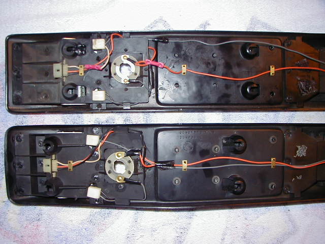

There are two screws in the dome light which can be seen below:
https://www.thirdgen.org/forums/inte...-overhead.html
Remove the above screws, then push the console forward if the car's a T-top or rearward if the car's a coupe. You'll be left with a wiring connector to separate (though from your description it may have been separated already).
You can see the white connector between the two forward mounting holes:
https://www.thirdgen.org/forums/atta...types-back.jpg
JamesC
