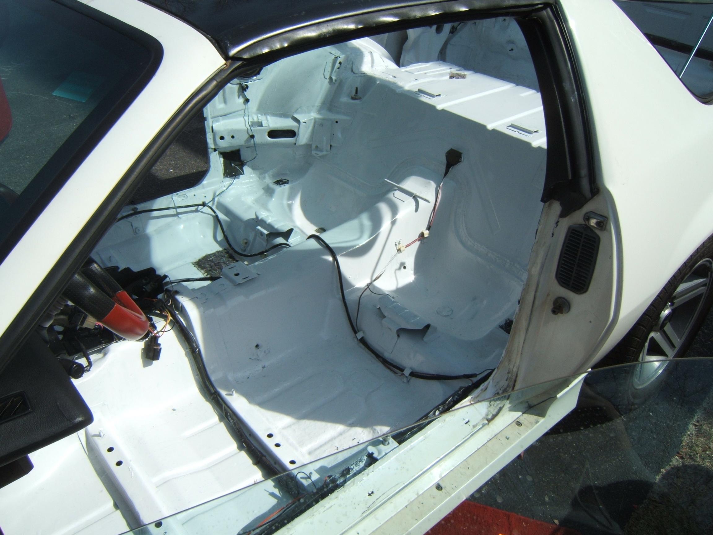

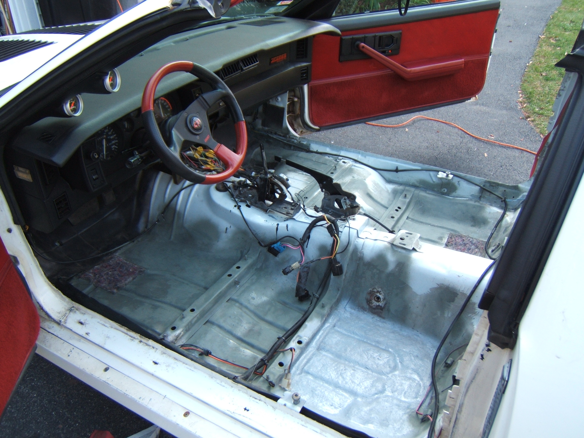

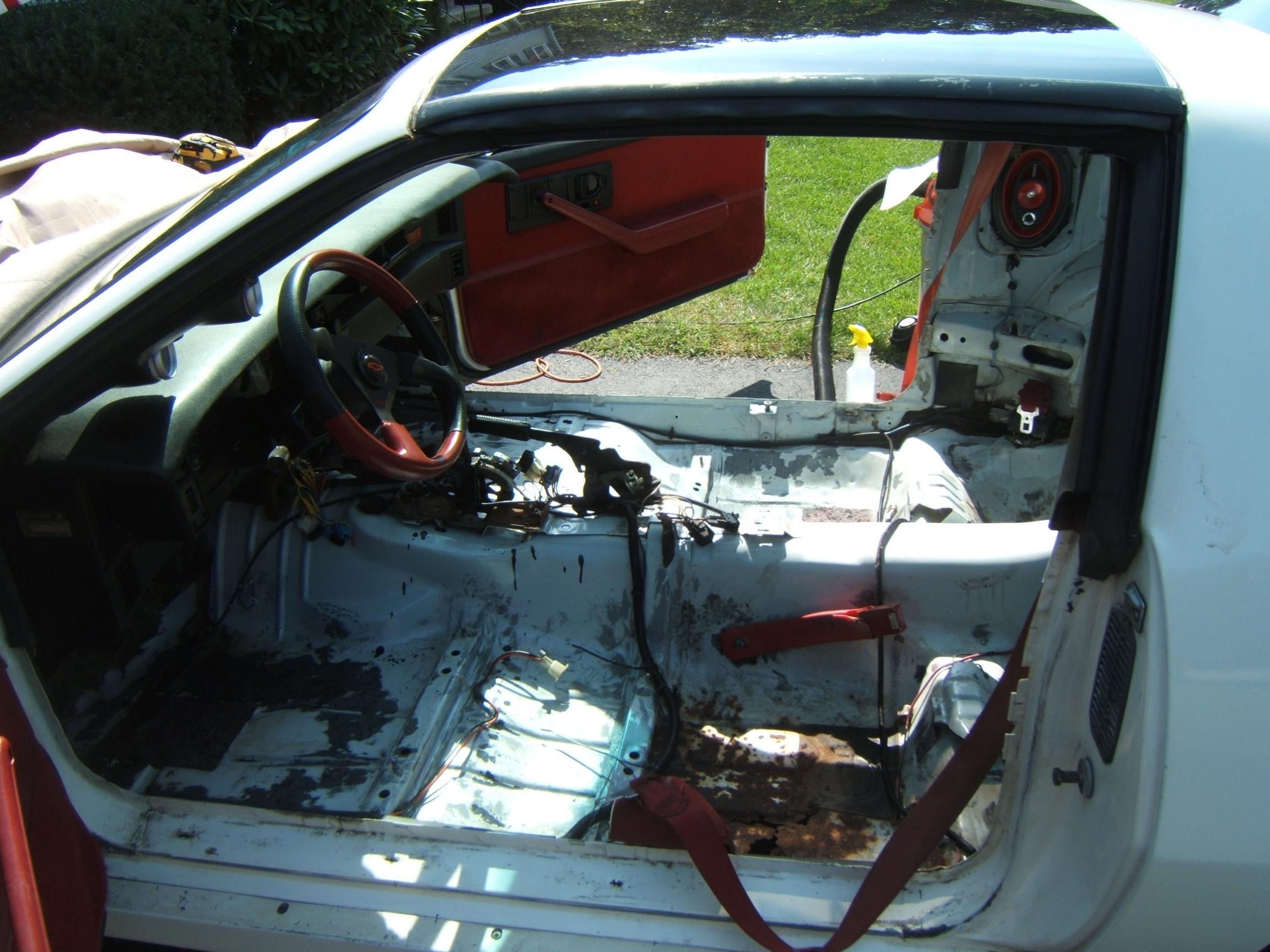

Having been through much worse, I can reassure you that it's not too hard. Buy the product of your choice and be sure to follow the product instructions. For example, some products will advise against removing the rust entirely. Rather, you scuff it up and the let the product do its job.
Here's what I did:
Scraped the floor with a plastic putty knife to remove old adhesives etc (specifically near the footwells).
Wiped the floor with degreaser and warm water.
Used spray cans of rust converter (which advised against full rust removal prior) and after a few days had gone by and the rust had been converted, so to speak, I then ground those areas flush.
Next, I scuffed the entire floor with a red 3M pad followed by a fresh batch of 3M seam sealer everywhere in the inside (where applicable).
I sprayed primer on the floor and to finish the job, I then used a special order Rustoleum paint (their version of Por 15 which also acts as a moisture prohibiter).
Since you will be attacking these areas, I strongly advise you to pull the hatch carpet as well. The trouble spot back there for me was between the spare tire and the passenger side wheel well.
Check out these pics of the job I did:
Attached Thumbnails Rust on Driver side and passenger side-drivers-side-2-august   Rust on Driver side and passenger side-drivers-side-3-oct   Rust on Driver side and passenger side-drivers-side-4march-pics

Rust that has formed is raised slightly higher than the rest of the floor. After a light pass with a wire wheel - still leaving some rust present - I washed the spots and sprayed them with converter (in photo 1 the dark areas had converter on them).
After a few days I sanded the spots - which weren't as high as before, but still a bit higher than non rusted areas - until they were smooth and level with the adjoining areas.
The dark red 3M pad is course, so when you move it across the floor, it lightly 'scuffs' the paint finish which assists top coat adhesion. Primer was sprayed on the 'converted' and/or bare spots and after one more quick vacuum and wipedown, paint was applied.
