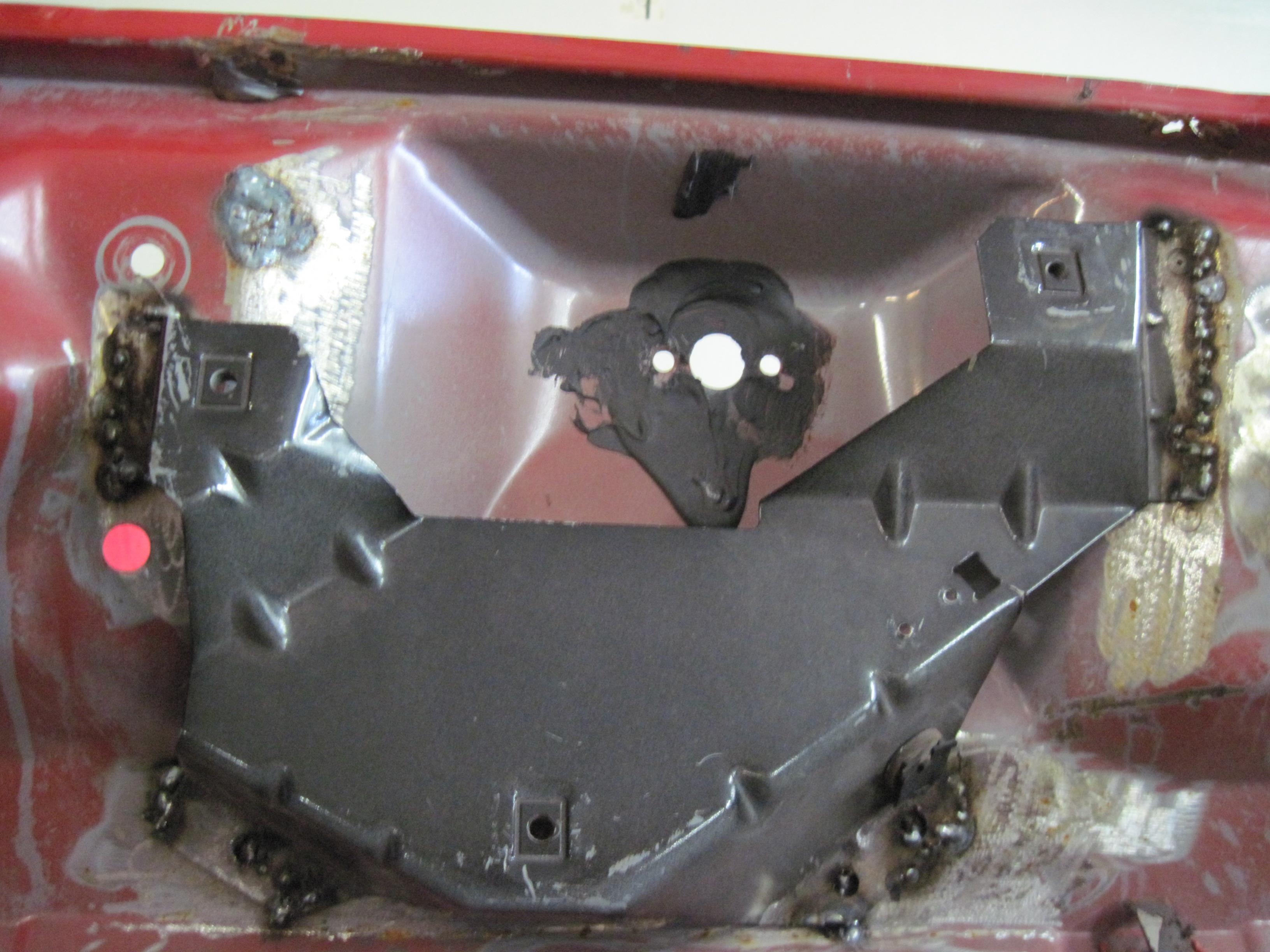

Re: Converting from Std. Latch to Motorized Pulldown
here are pics of the brackets.
black pull down bracket from an 86ta, installed on 85ta.

So it looks like i need to take the bracket off the donor car and weld it up to the 84 trans am? Took it off an 86 Camaro
Yup, hopefully the back panel is the same on 84s, pretty sure it is.

Oh and you have to remove the existing manual latch bracket.
